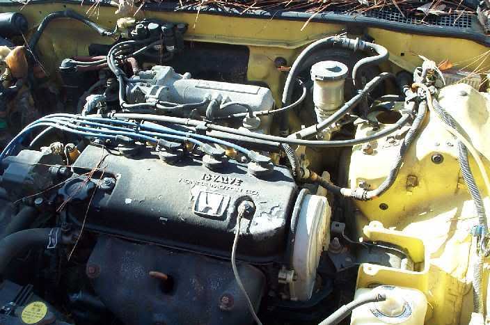

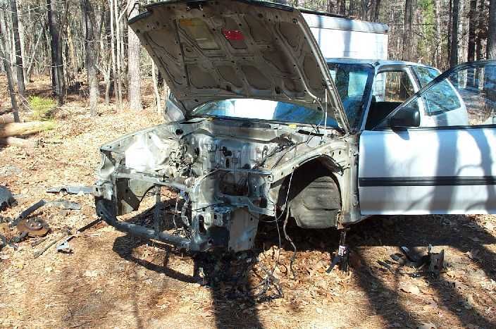

Whew, what a long day! I spent the entire day working on transferring the drivetrain from the busted yellow CRX to the less-busted Civic and I've definitely had my fill of rusty bolts, frozen coolant hoses and brittle plastic clips & plugs. It was actually quite refreshing removing stuff from the yellow CRX knowing I didn't have to worry about dinging body panels or the like but I still wouldn't call it "fun" as Ryan described earlier.
I even managed to disconnect everything from the motor before pulling it this time! Despite what my parents will tell you, I *can* learn something after doing it for the 4th time! :D
Obligitory busted yellow CRX motor pic:
Ignore the miscellaneous yard debris. That is left over from my Halloween decorations. I had the CRX dressed up as a scarecrow. When you don't have kids, you have to find ways to amuse yourself.
Anyway, after adding a body kit, a few stickers and putting the Civic in my makeshift paint booth, I think it came out quite nice. It really goes to show you that if you pay attention to details and put in enough time and effort, anything is possible.
Check out the results!
Pretty impressive, huh? I'm thinking of going into the Civic restoration business! :lol:

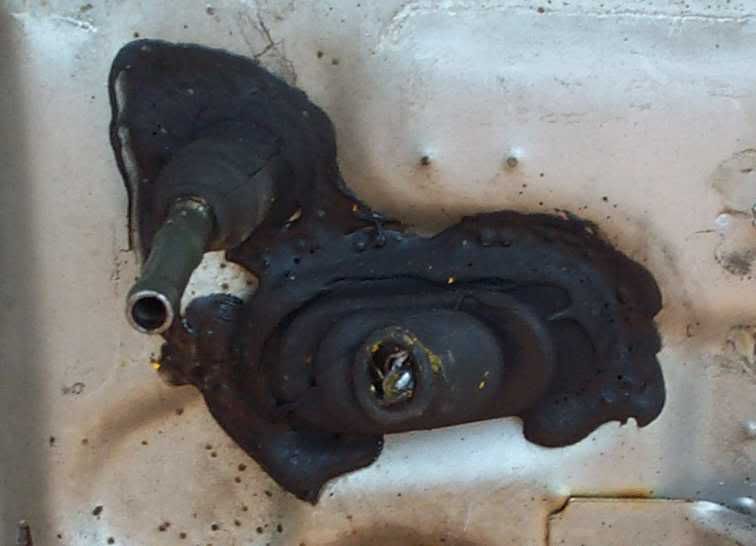

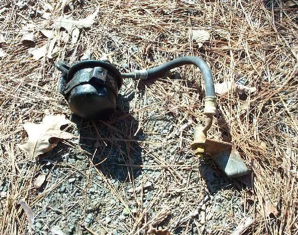

While some of you guys and gals were out frolicking in scenic Four Oaks, I spent most of the day tinkering with the Civic. In my (misguided?) quest to clean up the engine bay and repaint all the rusty brackets, I ran into an itty-bitty teensy-weensy minor problem. I was trying to remove the fuel filter from the hard feed line and even though I soaked the entire thing in PB Blast every day for 4 days straight, it snapped like a twig with very little effort from my line wrench. Doh!

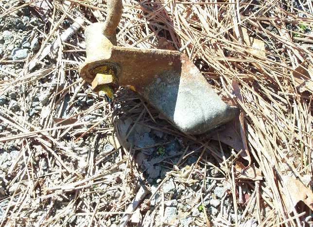

Busted Hard Fuel Line:
Do you see that mangled little nub in the lower right of the picture partially covered in yellow paint? That's supposed to look like a slightly shorter version of the tube in the upper left corner of the picture. That can't be good, right? Right! Suddenly my little Civic project just got a bit more "interesting"! If you define interesting as the desire to poke your eye out with a sharp stick, that is... :x
Here is a picture of the #$%@#$!!! fuel filter and the rusty bracket:
And a closeup of the rusty bracket:
See all that rust? I couldn't let that stand! Unfortunately my compulsiveness got the best of me and instead of just leaving well enough alone, I just *had* to clean that stupid bracket. Apparently I need to switch medication 'cause whatever I'm taking isn't working anymore. :? OK, maybe I just need to start taking medication-- I'm not entirely sure anymore.
Anyway, you can see the mangled end of the hard fuel line sticking out of the nut that attaches it to the bracket. I've always wondered where the other end of those lines went and now I had a perfect chance to find out! :roll:

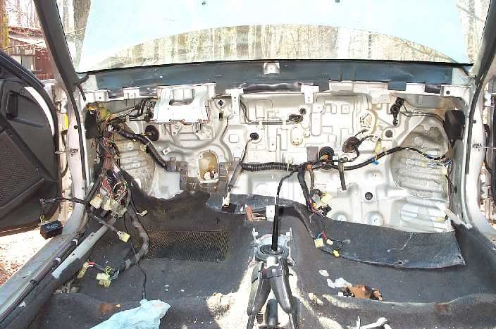

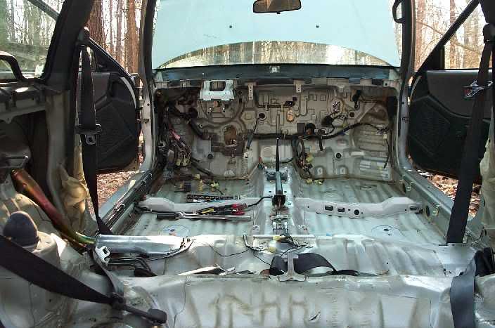

That doesn't seem that bad, does it? Right! In order to get to that spot in the inside of the firewall, I had to disassemble a wee bit of the interior. How much is a "wee bit"? (I have a feeling that somewhere Ryan is laughing hysterically to himself knowing what is getting ready to happen.)
This much:
:shock:
Yea, the entire dash had to come out! If you look closely, you can see the fuel lines snaking their way to the left and then up behind where the steering column assembly would be. So that meant if I wanted decent access to the lines, the steering column had to come out along with the entire pedal assembly. This is about as far as I got on Saturday evening so I'm thinking at this point that my original goal of getting the thing running by Sunday evening may be in slight jeopardy. Ya think? :lol:
That night I looked up the fuel lines on a few Honda parts sites and discovered that they weren't really all that expensive. The line I buggered up was ~$30 which I didn't think was too bad. I also contemplated making my own lines and did a bunch of research but in the end, I decided that dying in a leak-induced fire probably wouldn't be very fun.
Being the hard-charging go-getter that I am, I decided that Sunday was better spent goofing off so I didn't make any progress with the car. An unfortunate side-effect of that was spending some "quality time" in front of the computer researching various ways to make my project even more complicated. I mean, if I'm going to reach my goal of building this car in 4294967296 excruciating steps, I clearly needed to complicate things further. :eek:

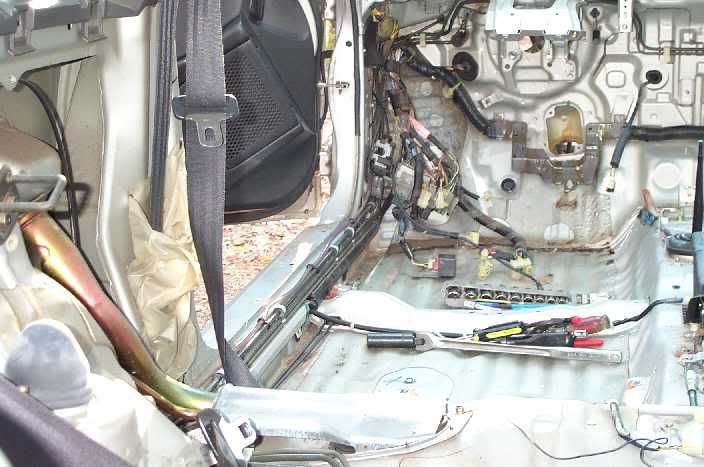

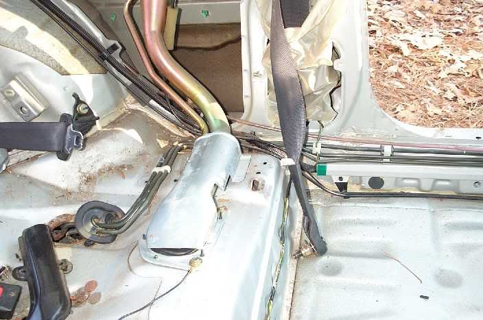

After removing the rest of the interior (with the exception of the head liner), I could now easily trace the hard fuel lines back to the fuel tank. You can see them running along the driver's side passenger compartment in the picture below. If you look really closely, you can see that there are 3 lines total: 1 feed line, 1 return line and 1 emissions-related line. I forget exactly what the emissions-related line is hooked up to in the engine compartment but I'll figure it out when I reassemble the entire thing, right? :)
3 hard fuel lines running along driver's side passenger compartment:
3 hard fuel lines disappearing under the car:

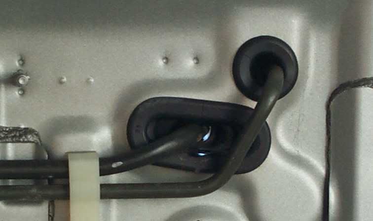

You can see in the picture above that the fuel lines must meet the gas tank somewhere after disappearing into the rubber grommet. I pried the grommet up to see what was under there and was met with another surprise.
Surprise! More rust:
There comes a time in every project where you step back and marvel at your accomplishments. This ain't one of them! :lol:
It looks like I'll be replacing all 3 hard fuel lines "just in case" which actually won't be too bad. The total cost will be under $100 and it will give me some peace of mind. Unlike most of the other parts on the car, these fuel lines aren't shared with their sister CRX so I don't have the option of using my parts car assuming they were in decent shape. For the sake of safety, it's probably smarter to go new here anyway.

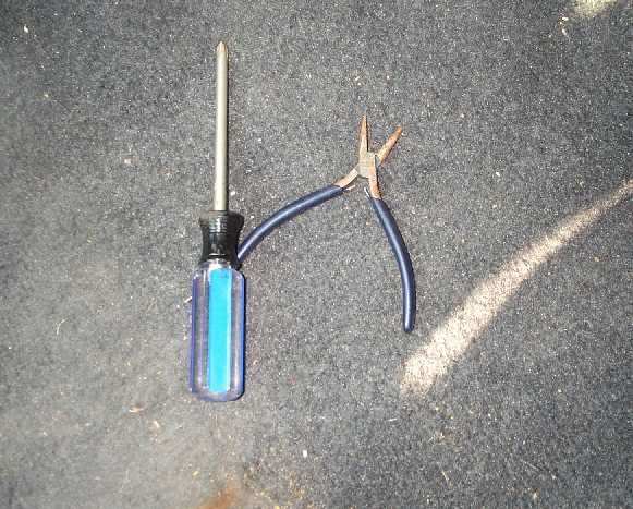

Yep, that's rust on the mini-pliers. :help: It's weird, I think every car I've purchased in the past 10 years came with free tools. I'm not sure what that means but I can't complain.
