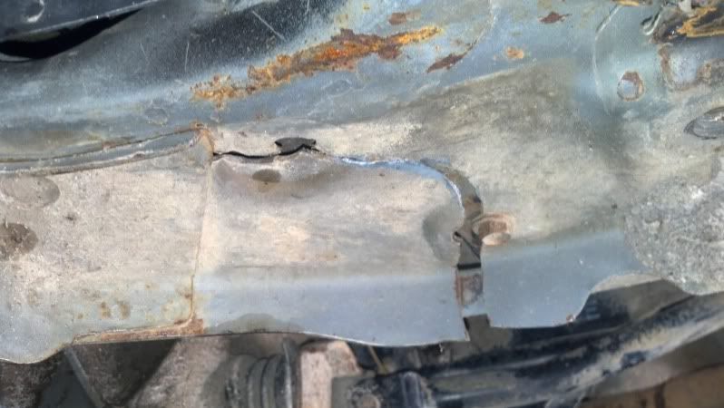

Update on the General's health.
This past Sunday Mitch and I got him up on the lift to install the new axle when we saw the reason the axle failed. That crack just above the right side tab where the lower control arm mounts shouldn't be there!

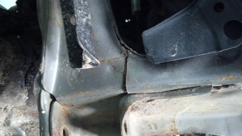

A little further back on the front subframe we found this:

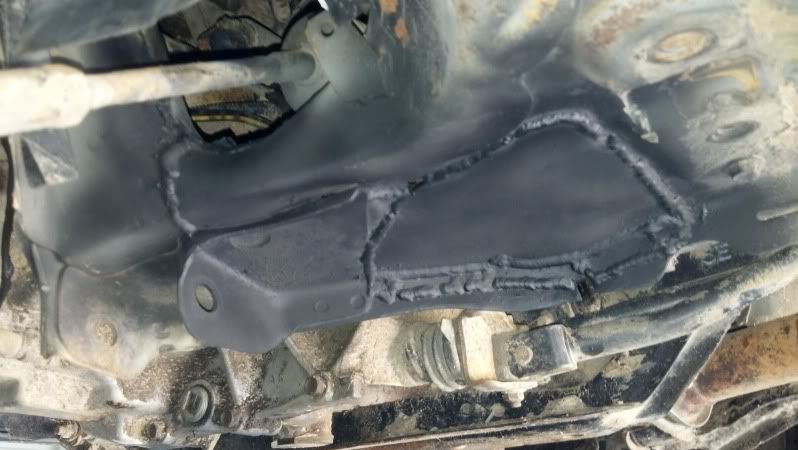

No problem, we removed the lower control arm and I welded in a plate to fuse it back together:

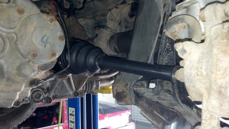

We popped in the new axle, added new fluid, put it all back together, and the old General is ready to go again!
