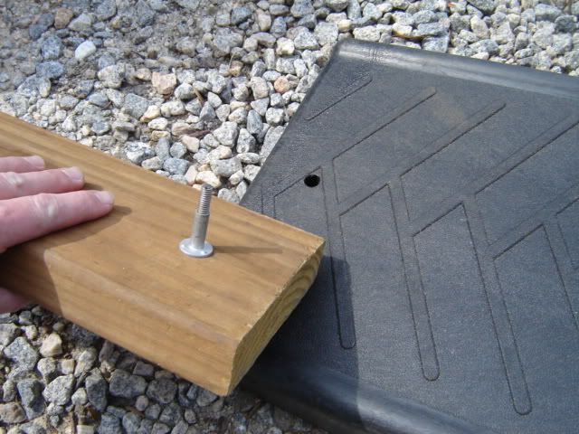

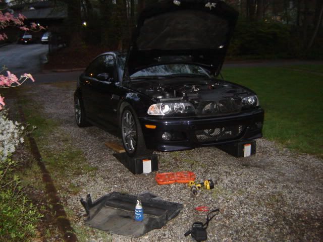

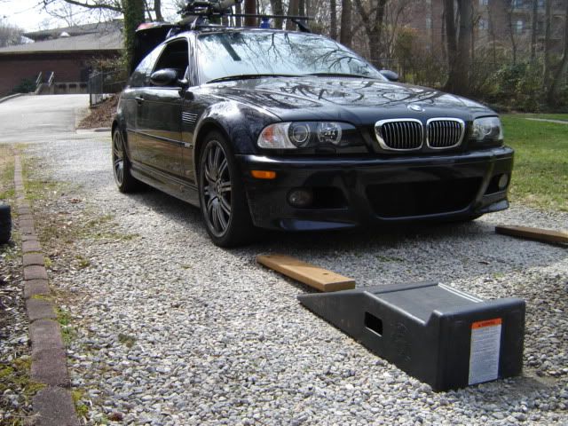

PostPosted: Thu Oct 29, 2009 9:29 am
Good call on the Rhino's. If possible, get the wider ones b/c it's only like $10 more but way easier to drive up on.
Also, if your car has a low front lip, just grab a 2x6 and stick a 2-3" bolt through it, lock it into the bottom of the ramp, and you're set.

PostPosted: Thu Oct 29, 2009 10:54 am
Thanks Matt -- just what I was looking for since the M5 sits too low to work with ramps.
