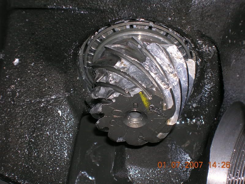

Sanford + 13x8's with V710's + a "spirited launch" =

I've seen that kind of thing in my days of rock-crawling, it was quite frequent as a matter of fact. Usually more the result of the driver than the equipment. Of course, that wasn't your case, was it Mr. Destructo?
