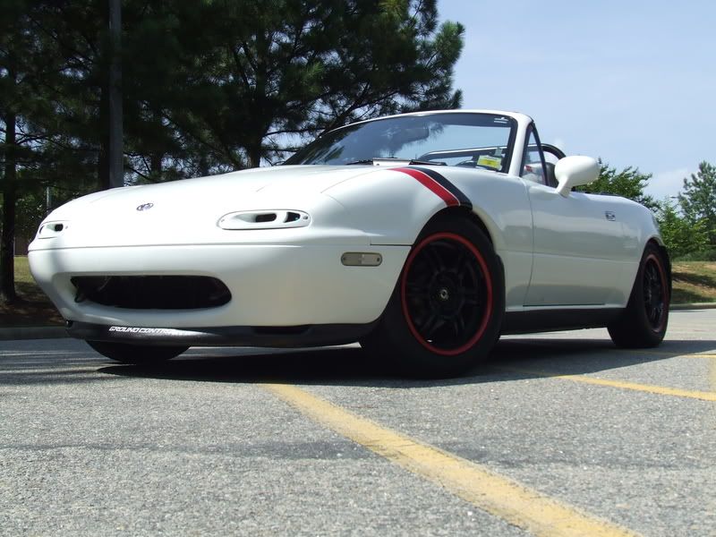

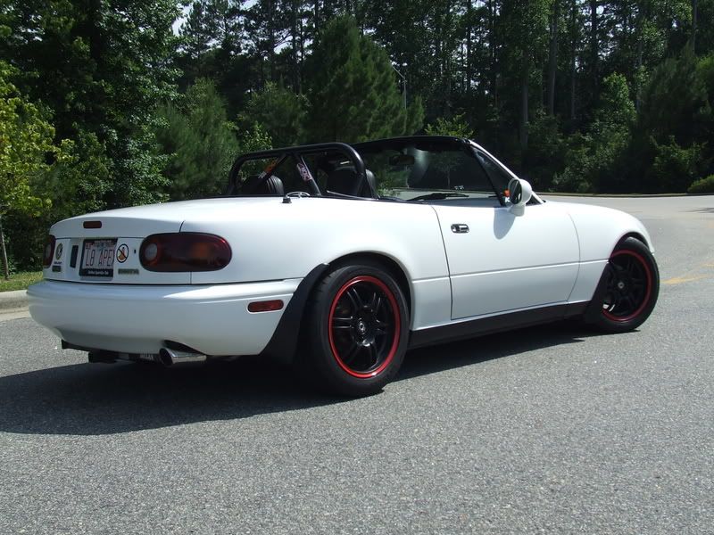

The new stance (eyeballed), before it goes to Mark Cooper....

PostPosted: Mon Jun 30, 2008 8:06 pm
What ride height did you go with (measured at the center of the wheelwell to the ground)? Did you go with NB rear top hats?
PostPosted: Mon Jun 30, 2008 8:50 pm
Joined: Sun Feb 26, 2006 3:04 pm
Posts: 544
I did not use NB tophats. I measured from the center of the fender to the middle of the wheel. I was getting about 12 inches. I probably need to raise it up just a little, but I figure when I have Mark align and corner balance it, it will be better dialed in and also at a more appropriate height, even though I love the way it looks now.

PostPosted: Mon Jun 30, 2008 9:19 pm
That's really low. I'm concerned that you're going to be spending a lot of time on the bumpstops, especially in the rear. You're also going to get a lot of bump steer due to the angle of the tie rods in the front. Anything less than 12.5-13" from wheel center to the fender is going to cause problems.
Just my couple of copper coins.
Good looking out playa! They are easy enough to raise up that I can "re-eyeball" the adjustment to a more acceptable level.

PostPosted: Mon Jun 30, 2008 9:47 pm
Jeb Brookshire wrote:
Since I'm "looking out", if you have the "Icehawk alignment" in your hands, just go ahead and throw it away. It really isn't aggressive enough. Mark has my settings in the computer, feel free to grab them.
Also, spend some time looking at Randy Stocker's Miata page as well as Shaikh Ahmed's Fat Cat Motorsports site for tips and suspension spreadsheets.

If you ain't layin' frame, you ain't trying. ;)
Seriously, Wes is right, 12" is TOOOOOO low.
