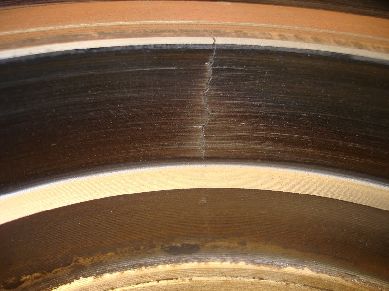

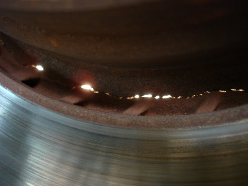

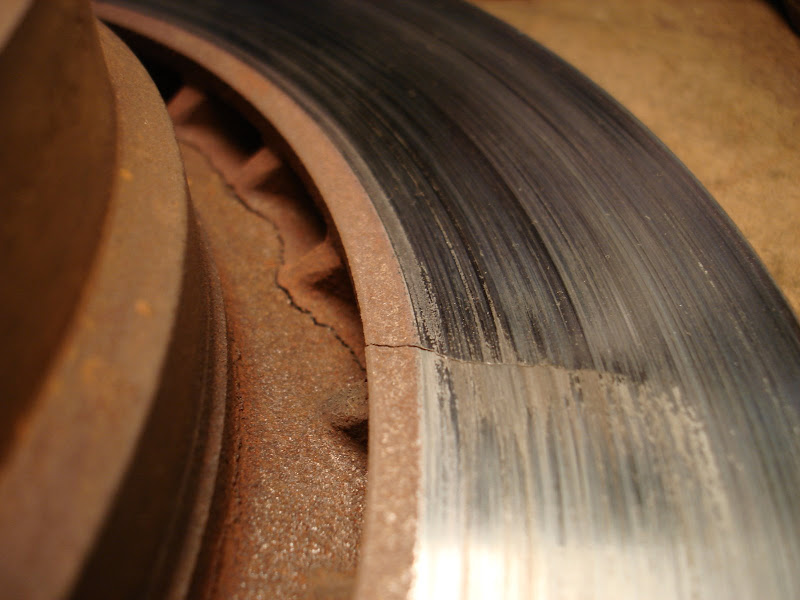

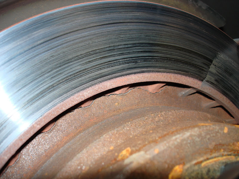

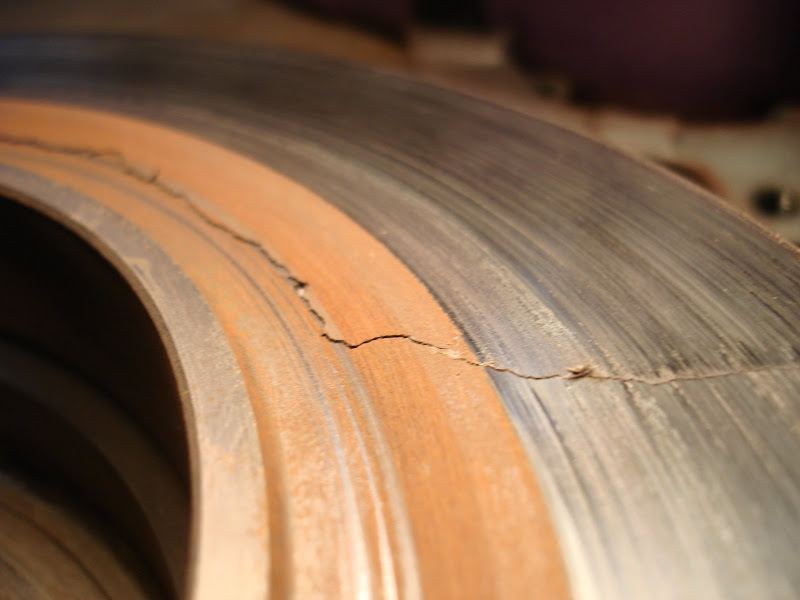

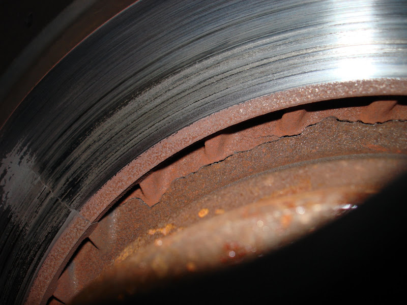

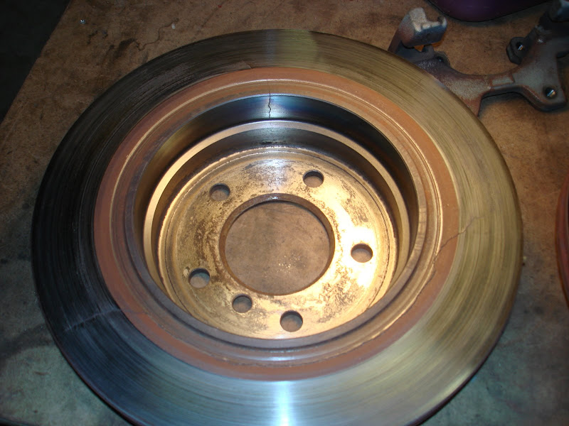

Had a BIG surprise when I looked at the rear rotors on the M3 right after the timetrial yesterday. Never felt a thing -- only noticed when I pulled the car on the trailer and was strapping it down. I dodged a big bullet.
Happened to both rear rotors with slightly different cracking pattern. It's through the dics (see the light picture below). These are BALO rotors sourced from Black Forest in September 2006. They have about 5k street miles, maybe 6 autocrosses, and 3 total days on track on them. Only been driven in the rain a few times -- that is surface rust. I was running Axxis Ultimates on street and PFC 97 pads on track.
I have some theories about how this happened - any comments?

I've been told that the cracks occur when the rotor is cooling down not on the heating portion of the cycle. So your next session would have been spectacular, if you didn't feel the rotor imbalance. Makes you wonder what would have happened if the 30% or so of the rotor let go when you were rolling.

If you look at the wear pattern near the cracks it appears the rotors were cracked while they were being used.

What's your thinking Mike? Can you tell where the crack originated on either rotor? Unless they are using thinner cross-sections in their design, I'm stuck on the material properties or a manufacturing error.

It is amazing that the rotor(s) are still in one piece with that large of a crack.

I'm surprised you didn't feel it. I would expect pulsation in the brake pedal even from the rear. From the front I'm sure you would have felt it and probably heard it coasting down pit road to grid.
My theory:
Look at the 1st picture. Read the crack from the right side of the picture to
the left side. More or less how the crack grew.
The crack on the right running across the surface. During the cool down cycle after a session. That started from the usual spider crack growing. Then it starts splitting. It grows in both directions moving to the outer and inner edge. The outer edge is the first exit for the crack. The outer edge has more temperature drop at a faster rate during cooling. Now there is only one place left to go. Towards the inner edge. This is a rear rotor and appears it has the emergency/parking brake inner ring. This means more material. Not the path of least resistance. So the weakest link is the thinnest material. That is to follow around that inner ring. At some point another weak spot on the rotor surface, from another spider crack, splits. The crack now starts moving through the weak spot towards the outer edge. The only thing left holding that big chunk of rotor surface in place appears to be the vanes.
A front rotor wouldn't do this as there is no path for a crack to chase its way around. It would just split the inner edge too and be done.
I don't consider this to be a defect. It's a plain old rotor. Never designed or intended for track use or race pad use. It did what they do. Failed due to heat stress over X thermal cycles. The cracks appeared at the places where the metal was weakest.

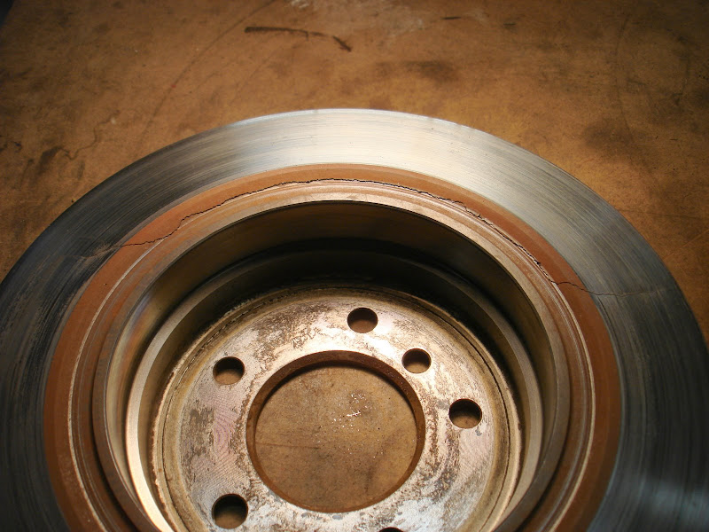

Actually the vanes are not holding the rotor together -- only the outer 1cm or so of rotor surface. The crack didn't make it to the edge anywhere.
On the other side (don't have a good pic) the cracks are only through the hub/vane surface and hadn't yet made it "out" to the rotor working surface.
Edit - pic #3 might be misleading. This is the inside of the parking brake surface -- not the actual rotor brake surface. One of the cracks appeared to start there.
Here - pic #3 is a closeup of the top crack in this picture. It doesn't connect to the "main" crack anywhere:
