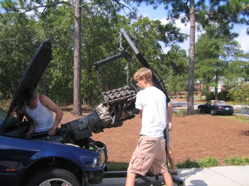

hey everyone i thought i would share some pictures with you from the past month or so of work i'v been doing. and last but not least i would like to thank Ron Spencer for leting me borrow his engine lift.
the new car, its a 97 318i, but not for long.
the 1.8 coming out
what a big open space
the 2.5 on its way out

Wow. That motor is huge*. That is a six, right?
Is that a pretty straight swap or do you need to swap computer and harness?

yep its a 2.5L inline six. i was planing on swapping it stright into the new car, but then i found a deal on a 3.0L out of a 95 M3 so i am rebuilding that and swaping that :twisted: . it will all bolt up nice and easy. i will have to change the wiering harness and computer along with the pedals, master cylender and brake booster because it was an automatic.
