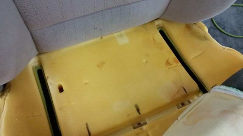

So Saturday morning I started by removing the heavy as f*ck passenger seat and putting it on the bench to work on disassembly.*@#$*@#$ After surveying it for a bit,*@#$ I determined I could remove the fabric on the lower half without removing any of the plastic trim bits.*@#$ I was able to simply undo a few plastic clips and peel the fabric forward. There are grooves in the foam on either side that correlate to velcro strips sewn into the fabric. When I got to the first seam, the fabric was held in with hog rings. I clipped the hog rings and pulled the fabric further forward as seen here:

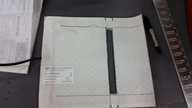

Next, I cut the heating pad to the correct length and marked the area that needed to be removed to replace the hog rings.
After the pad was cut, all the exposed edges has to be insulated with a fabric strip provided in the kit. The pad is held in place with double-sided tape and the hog rings reinstalled as seen here:

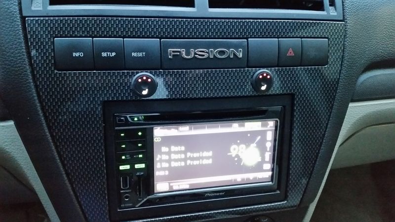

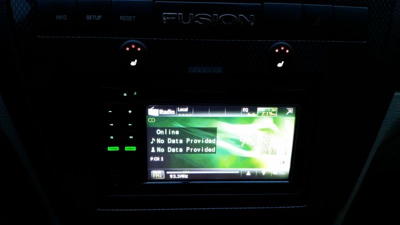

After the seat was in place, I finished the wiring and mounted the switches in the bezel around the stereo. Here are a few pics showing the switches. The logo lights up and there are three LEDs which indicate high, medium, low, and off.
