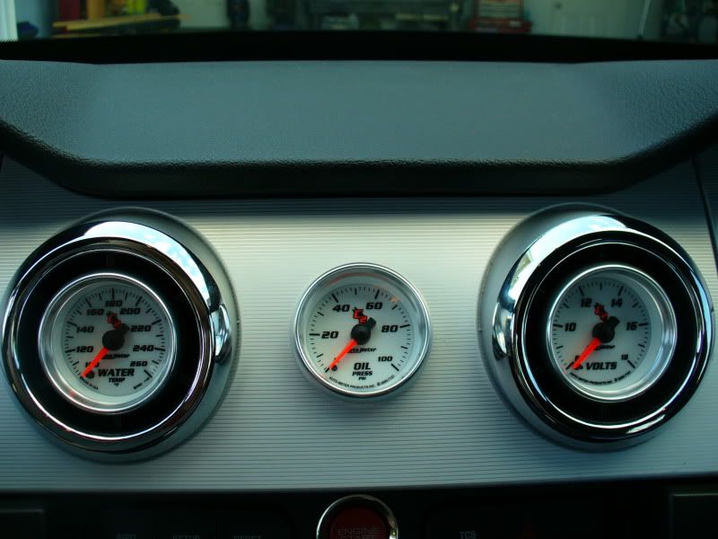

Cash Davidson wrote:
Yeah, I got my new 2.5" mechanical gauges for oil pressure and water temp. Just need to find the right place to mount them. :)
IIRC, you can buy the same vent pods for the Mazda 6 like I have. The vents still function also. Here's a picture of my gauges in the Mustang:

You obviously haven't seen the interior of the Mazda6 lately.
:mrgreen:
I have cleaned it up a bit. It has no side glass not to mention vents. :D
