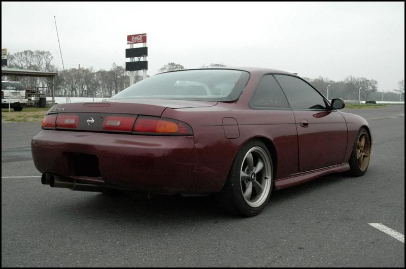

I do know the S197 offset is almost in FWD territory. My '07 Mustang 17" Bullitt wheels I have will actually fit my '07 Fusion just fine.
 Post subject: Re: Mustang Wheel Applications for Other Cars?
PostPosted: Wed Aug 31, 2011 11:40 am
Civic Si, Is300, and Type R :wink:

That's the same bolt pattern for the 240sx, most of the 5 lug Nissan cars, Mitsubishi eclispe and the Mazda Rx7/8/
If they fit over the 12" brakes of the new Mustang, they are going to stick out.

Thanks for the pics Ryan!
Looks like I won't have any problem finding a "market" for the wheels if I need to do so. Now all I need it a market for the whole car rather than the dealer. Shouldn't be too hard given low mileage (91K), one "mature (in years)" owner, and totally stock. :)
