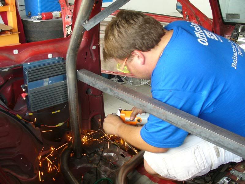

Here’s Ryan removing the paint for welding the main hoop mounting points:

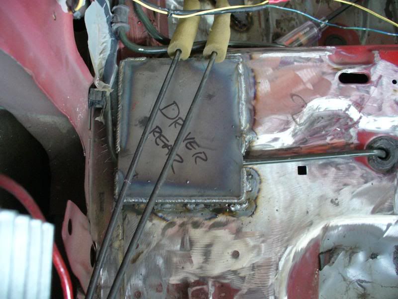

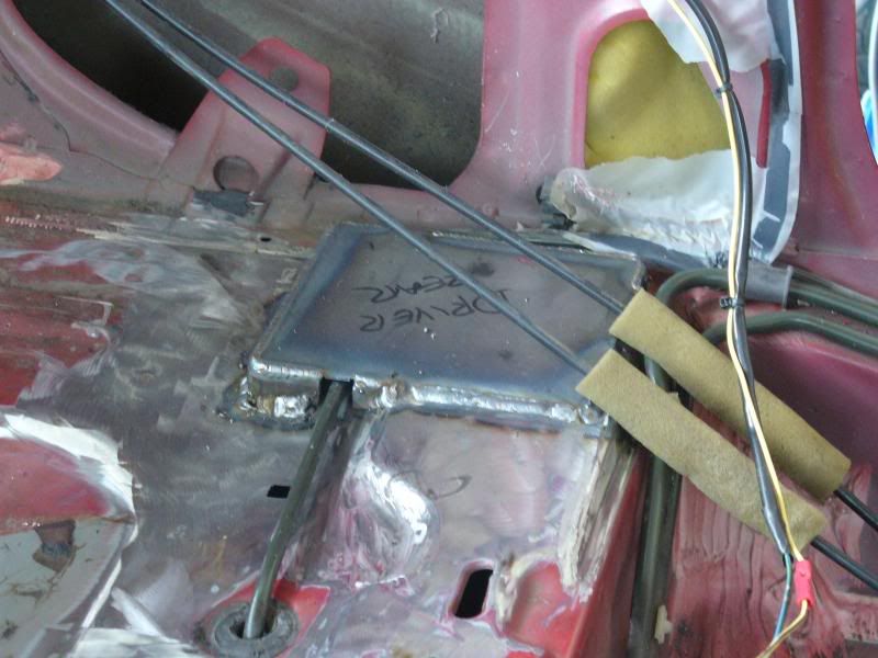

Of course there are no flat spots in this car, and there are wires and lines to work around so we had to make the base plates special:

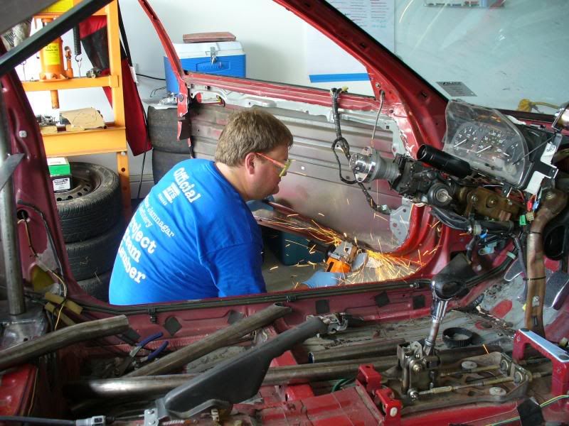

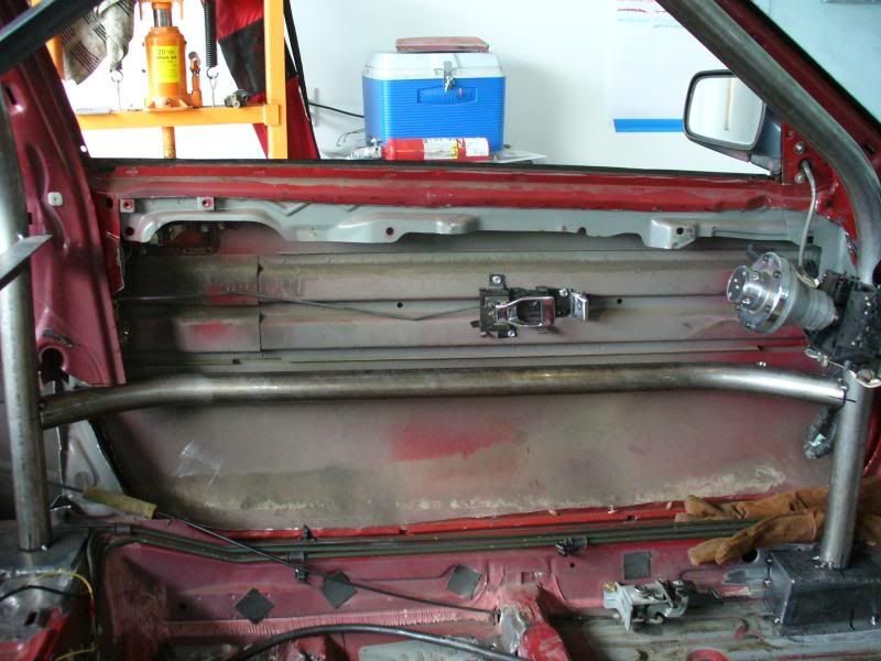

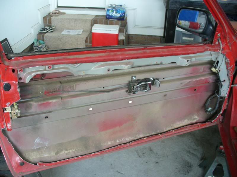

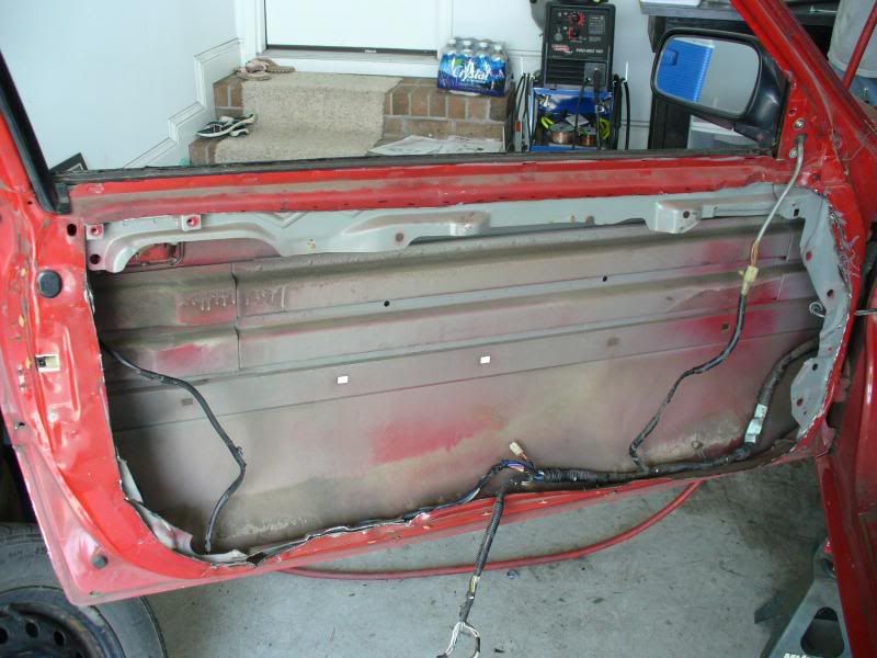

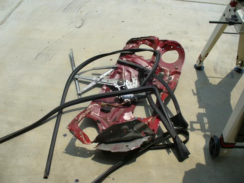

Removal of the driver’s door guts to allow room for the door bars:

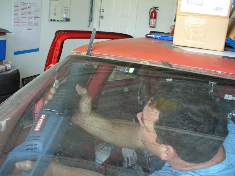

Randy Melton stopped by and came up with an ingenious method of removing the rear glass using a sawzall blade with the teeth removed. It worked great!

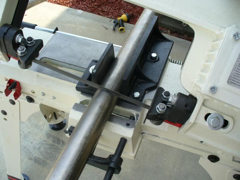

Here we are using my new bandsaw to cut the extra length off the main hoop legs:

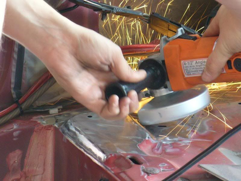

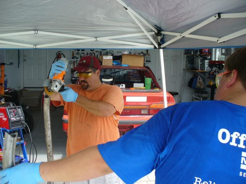

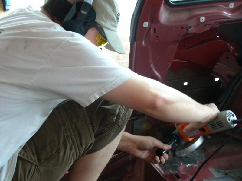

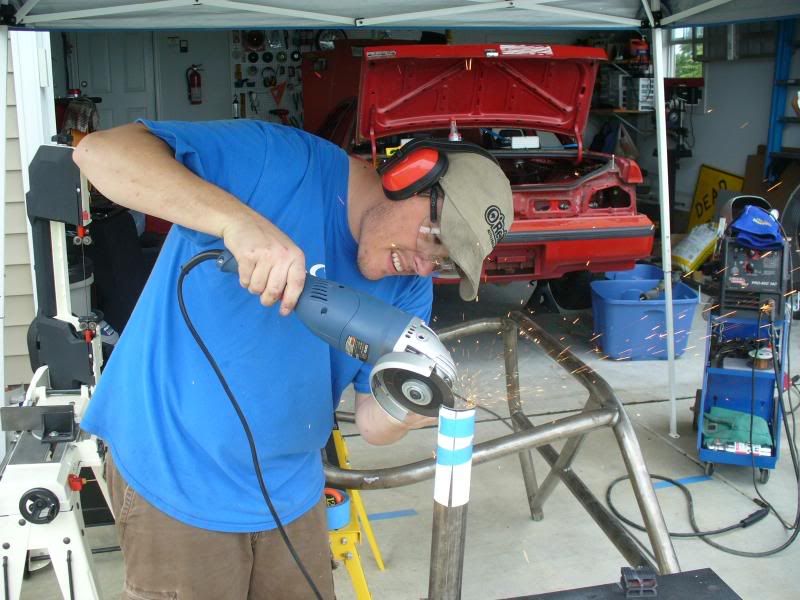

The halo bar needs to sit way up in the roof so Ryan used up no less than four of my cutting wheels removing the extra double-walled metal:

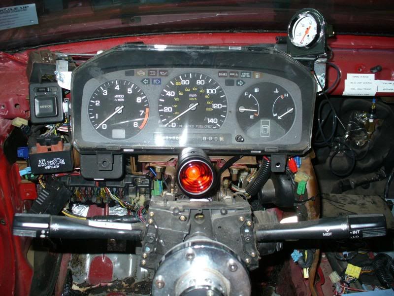

We have been told several times that our B20A engine will suffer damage easily if it’s over revved, or even driven on the redline for any length of time. Therefore I mounting a shift light last night to help us. The inside of the lighting surface was black so I masked it off and painted in bright silver (didn’t have any white) to make it brighter. Then I swapped out the standard #194 incandescent bulb to the new SMD-style LED that I’ve used in the gauge lighting in my car. I did a test with both and the LED is at least 2X as bright as the standard bulb. Here are a couple of shots, one of the light housing itself (using the flash) and one with the light actually on. It’s pretty darn bright! We should have no trouble seeing it even in bright sunlight.

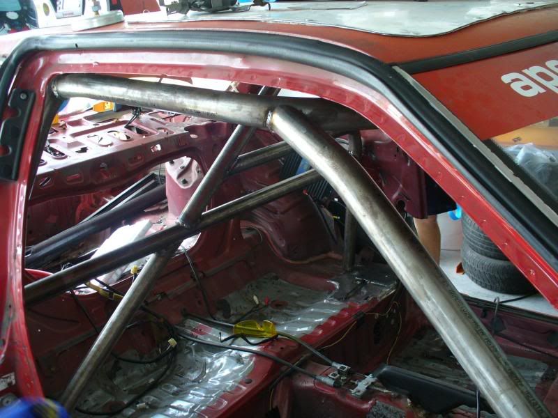

Well we had a pretty productive weekend on the cage installation. It’s 95% complete, at this point. Here are the build pics from this past weekend:

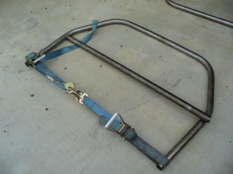

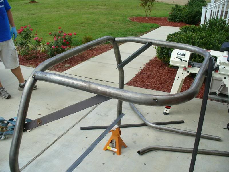

First, nothing ever fits the way it should. Here you can see the main hoop legs are being drawn inward with a ratchet strap to get them to the correct dimension. Notice the horizontal bar laying there? Yep that had to be cut and re-notched as well.

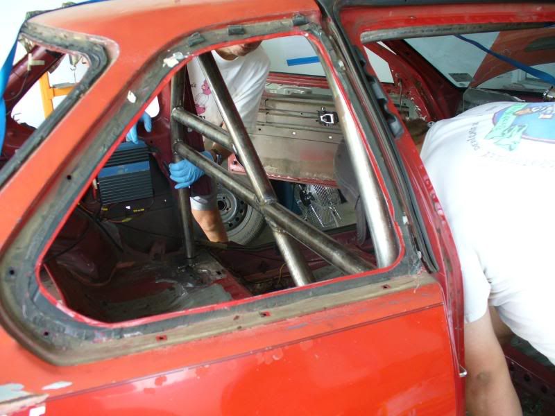

Here we have tacked the halo to the main hoop and the A-pillar legs in place to see how it would all fit and added temporary braces to hold it all in place.

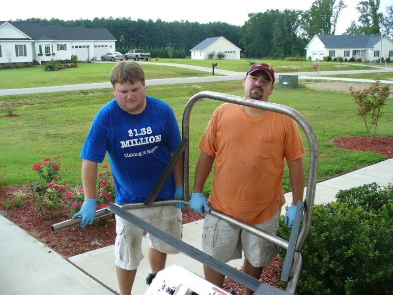

Chris and Stephen take it for a test fit in the car. Will it fit?
H*ll no! The halo bar needed to be about 2” shorter so we had to cut and re-notch it as well.

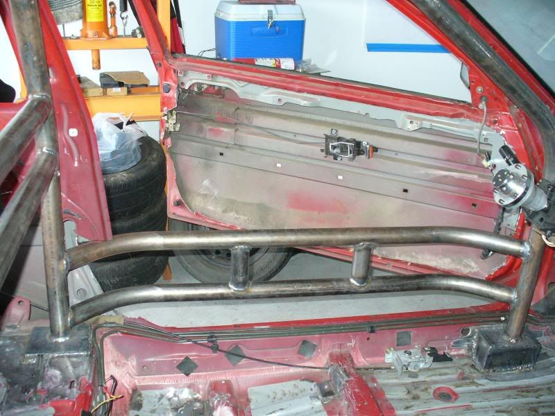

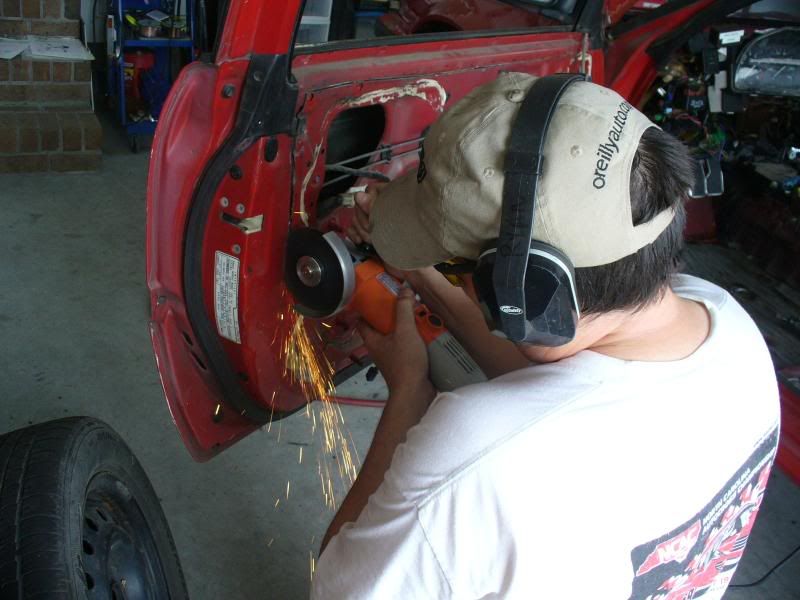

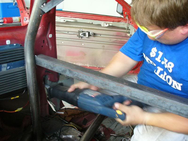

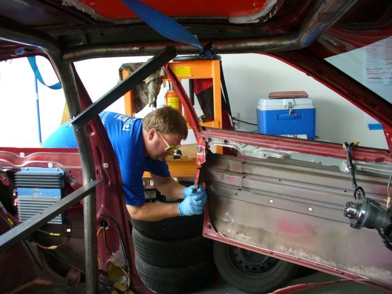

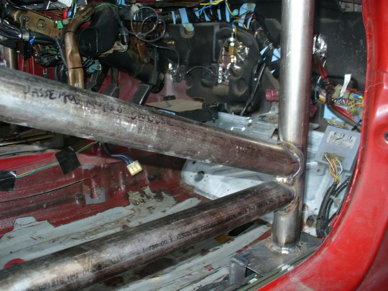

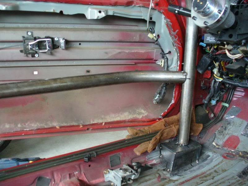

Here the assembly is sitting in the car and held in place to the roof with a ratchet strap. Stephen is cutting the door to provide clearance for the NASCAR bars. In the last pic you see the door latch had to be relocated due to the modifications.

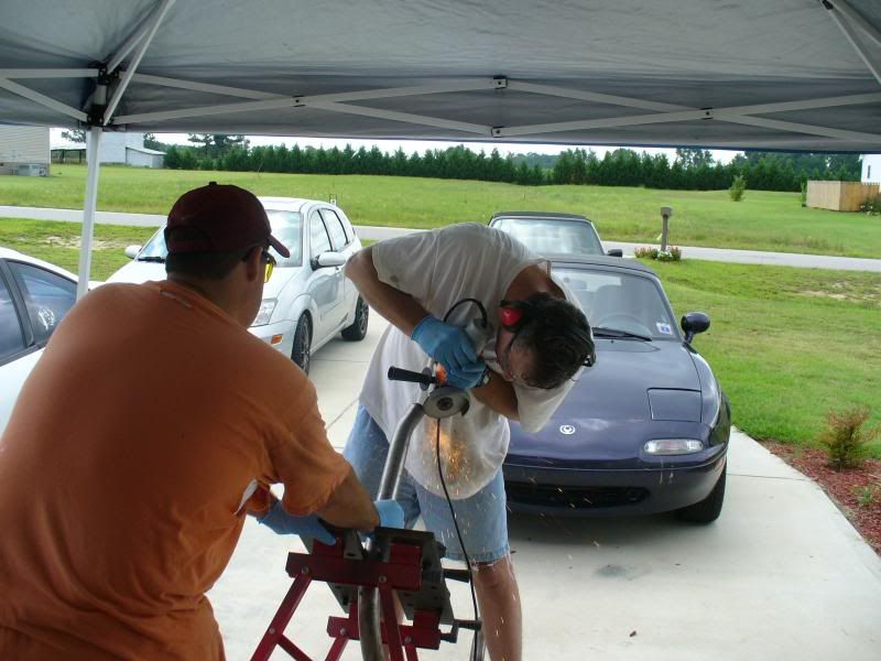

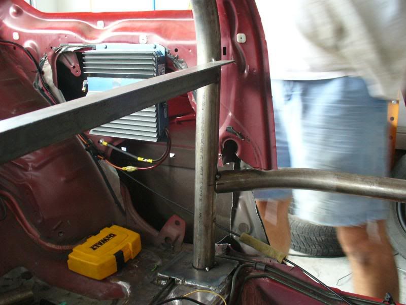

The B-pillar had to be notched to provide clearance for the NASCAR bars also. Here Stephen is using the grinder and sawz-all to GIT-R-DONE.

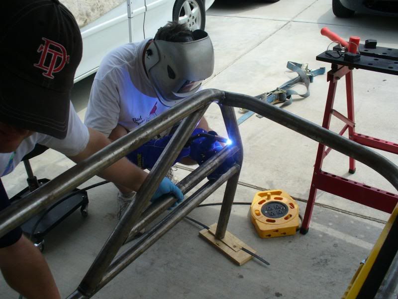

We had to build plinths for the front legs so the A-pillar bars could be dropped later and fully welded. Here the NASCAR bars along with the A & B pillars are tacked in place and marked.

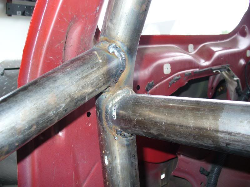

After we lined everything up and marked it, the main hoop and halo assembly was removed so all the joints could be fully welded.

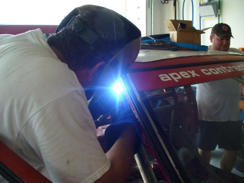

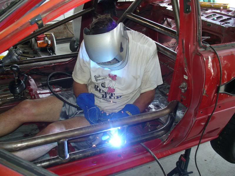

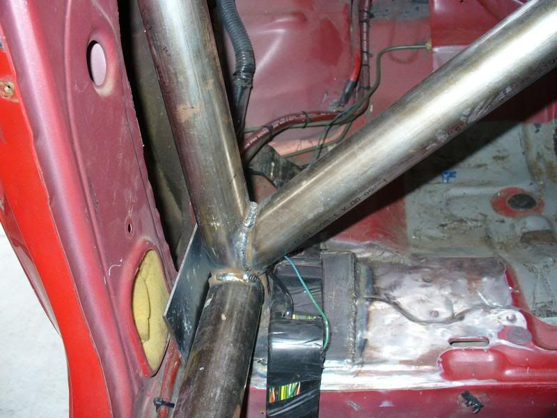

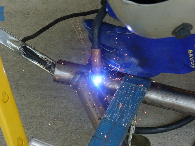

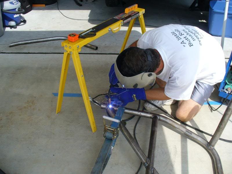

Would the horizontal bar on the main hoop work correctly to mount the harness? Of course not! We had to make our own. Here Ryan is cutting the notch and I’m welding the bar in place.
Once all the welding on the main hoop was done we set it all back into place.

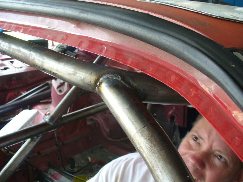

After tacking the A-pillars to the halo, we were able to slide the whole assembly backwards and off the front plinths. This dropped the halo enough to provide access to fully weld the A-pillar bars to the halo.

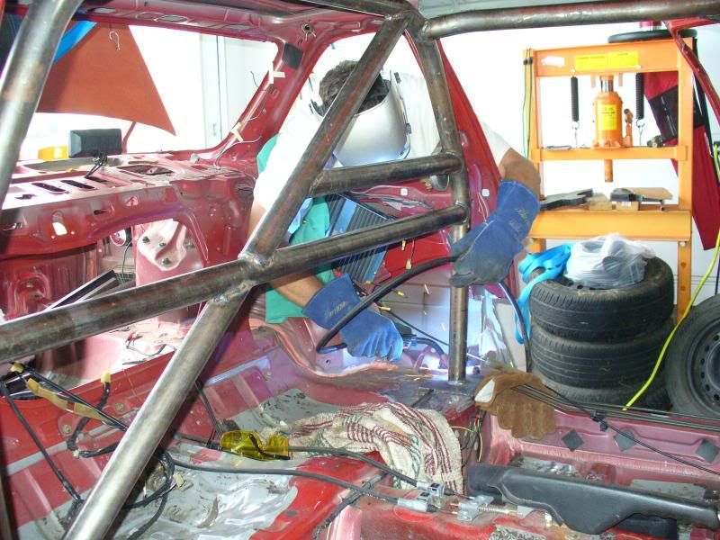

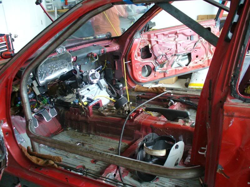

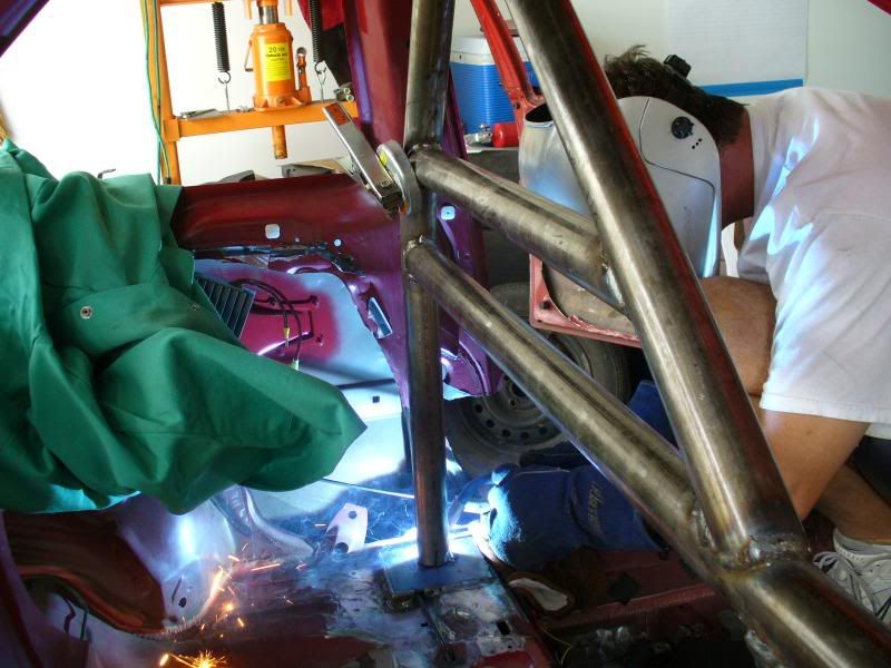

Next we set the entire assembly into the final position and welded the main hoop and A-pillar down bars to the foot plates and plinths. Notice in the second pic how you need to be an octopus to weld some of these joints.
Last step (for yesterday) was to weld in the door bars. Again you need to be able to weld standing on your head at odd angles.
