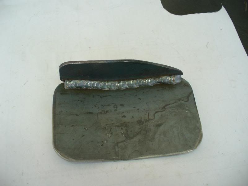

More pics of the work I have done on RiZo this week.

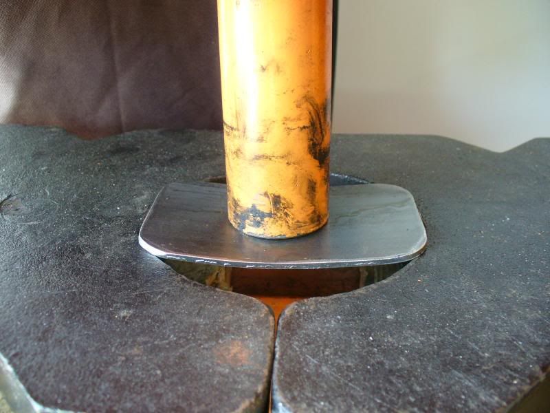

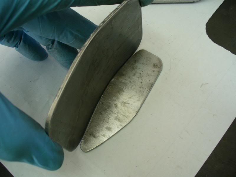

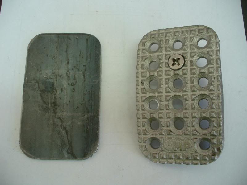

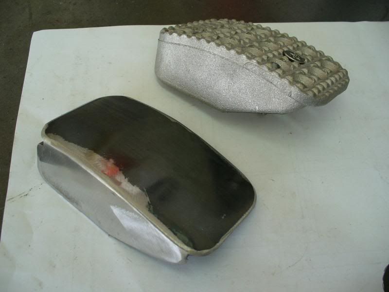

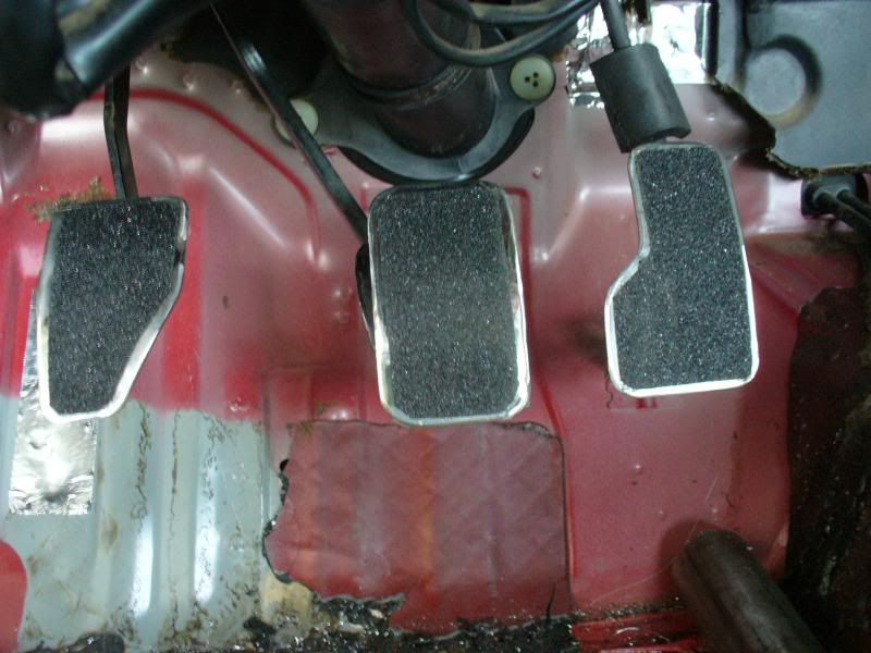

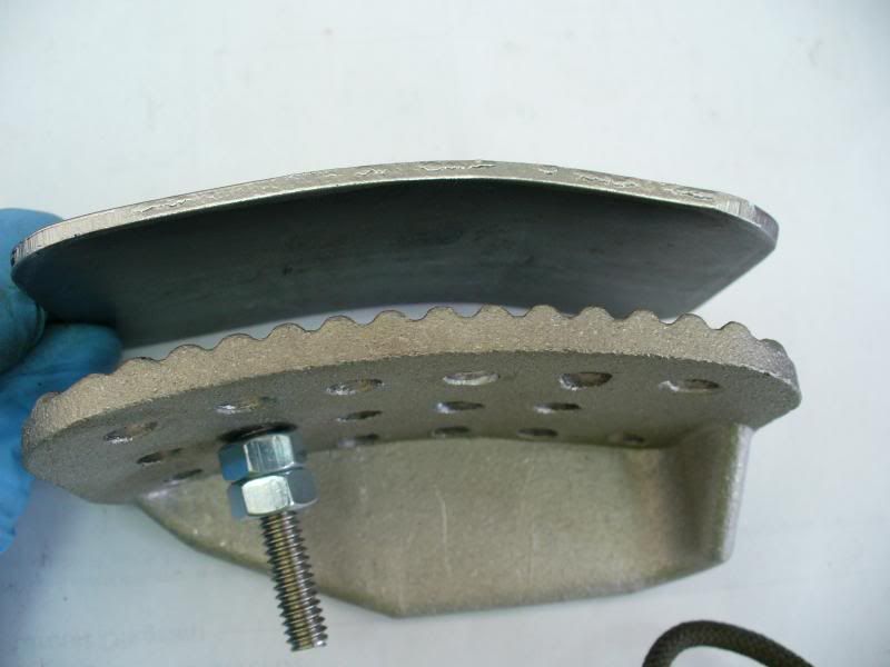

We decided to make our own OMP-style pedals to save a little money. I used 1/8” steel plate and grip tape. I curved the plates to match the OMP ones with the press. For mounting, I welded ¼” studs on the back of each pedal. Here are a few build pics:

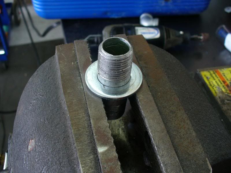

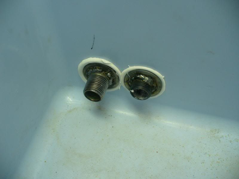

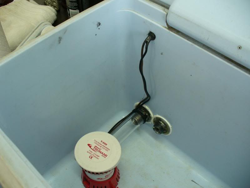

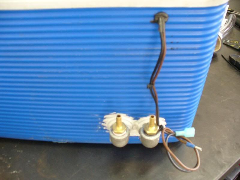

A co-worker gave me a cold therapy cooler/pump setup that his wife had to use after shoulder surgery last year and I planned to use that for our driver cooling system. However when I pulled it out yesterday to mount it I saw just how tiny it was. It was definitely too small for what we needed so I had to ditch that and build a system from scratch.

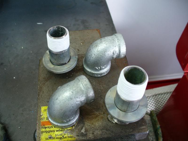

I had an existing cooler so I decided to use that. Next I bought a 12V bilge pump from Wal-Mart and some pipe fittings from Lowes. With a little welding (because flanges had to be added to the pipe nipples) and RTV I’ve put this together:

PostPosted: Thu Jul 30, 2009 3:13 pm
damn fine work McGrubber.
is that cooler larger than the one in Dieter?
PostPosted: Thu Jul 30, 2009 3:16 pm
Posts: 229
Location: Willow Spring, NC
The real question is how many 12 packs does it hold? Good job with the engineering on all the parts.

VK did you TIG weld your pedal covers? I ask because those look like individual TIG style puddles vs. continuous MIG weld.
Nope, it's MIG...but thanks for the compliment! The 'stack of dimes' look on the weld is from the technique used, not the machine/process. You can do the same with a SMAW (stick welder) with enough practice.

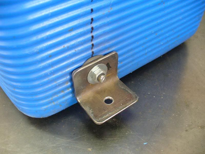

That looks like it will work great. Have you thought of putting a pipe through the bottom with a valve to drain the cooler between races? Save you from having to unbolt it to drain it.
Mark Barnes
PostPosted: Mon Aug 03, 2009 8:19 am
"Unbolting it" only consists of two wing nut/bolts. I welded plates with nuts to the floor so it's really quick and easy. Also the pump itself could evacuate 90% of the water.
We tested it yesterday with a Cool Shirt and it works great.
