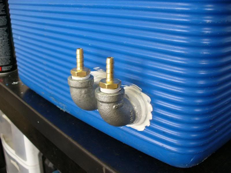

A co-worker gave me a cold therapy cooler/pump setup that his wife had to use after shoulder surgery last year and I planned to use that for our driver cooling system. However when I pulled it out yesterday to mount it I saw just how tiny it was. It was definitely too small for what we needed so I had to ditch that and build a system from scratch.
I had an existing cooler so I decided to use that. Next I bought a 12V bilge pump from Wal-Mart and some pipe fittings from Lowes. With a little welding (because flanges had to be added to the pipe nipples) and RTV I’ve put this together:
VK, I did something very similar and had some questions.
I used the CPC dry break fittings like a real cool shirt, I ordered these (got the part numbers from somewhere on the Internet) from McMaster-Carr:
http://www.mcmaster.com/#5923k61/=3r99hp
http://www.mcmaster.com/#5923k31/=3r9a7e
These worked fine with my homemade cool shirt, but one of the drivers showed up with a store-bought FAST cool shirt and it had slightly different fittings. They were CPC fittings and looked like the ones that I was using, but slightly different so they would not mate up properly. Where did you get your coupler fittings and what did you use?
Also, how long did a cooler full of ice last? Mine would make it a couple of hours with the cooler filled about 3/4 with ice and a few inches of water in the bottom. After that it rapidly got useless and needed more ice. I did use a really ancient and crappy cooler, I basically looked around and picked the cooler that I would least mind getting holes cut in it. I'm thinking that next time I'm going to use a really big/nice cooler that I can load up for the day, something like one of those 100-150 quart marine coolers. After being out there with the cool shirt working, I can't imagine doing without it. I mean, maybe if I lost a bunch of weight and got in good shape, but it seems a lot easier to just buy a big-ass cooler.
