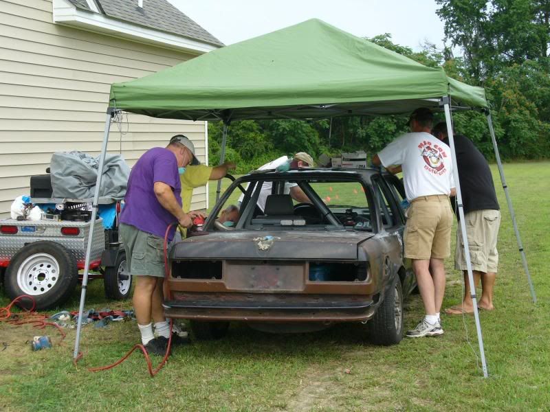

Having finally been notified that we are officially ‘IN’ for the fall 24 Hours Of LeMons race at CMP, we had a big work weekend over at my house. Members of Team Magnum PU, Team Dorifto Dogs, and Grim Reaper Racing came to hang out and turn a few wrenches. We would especially like to thank to Mark Barnes and the rest of his team for driving East and lending a hand. Yes little Johnny, there is life East of Raleigh.
Here are a few pics of the build progress from this weekend:

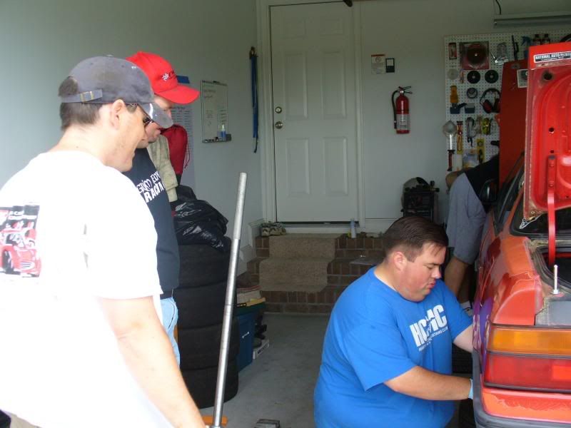

Here is shot of Chris Brown apparently trying to suck start the engine:
Ryan doing what he does best…getting dirty and breaking sh*t.

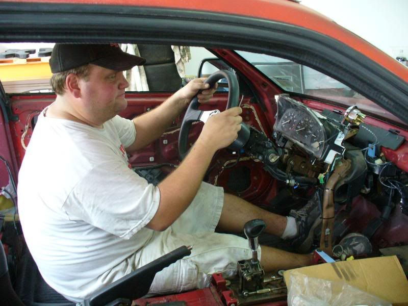

Here is Stephen testing to see if we actually even need a seat at all.

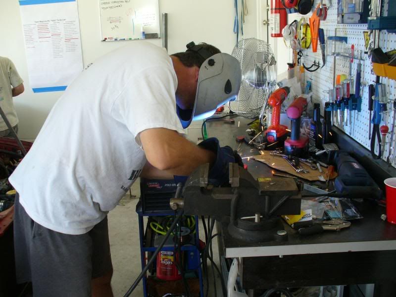

Here I am welding the shock back together after Chris tried to compress the shock shaft with an impact.

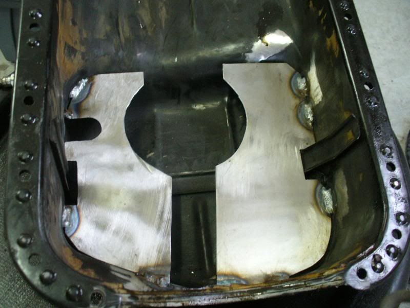

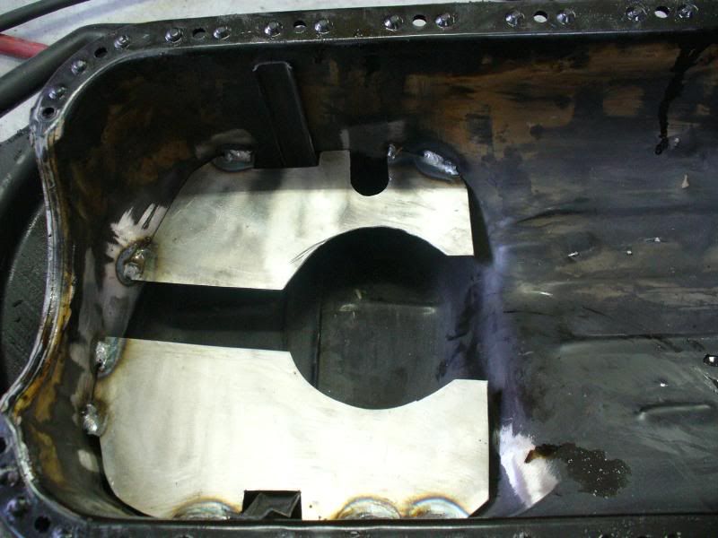

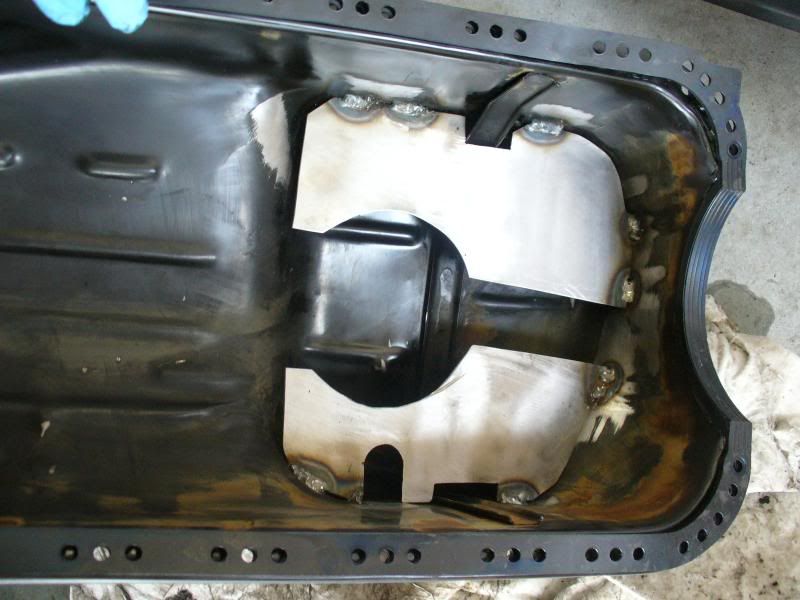

Since the B20A is the red-headed step child of Honda engines, there aren’t many off-the-shelf parts available. We were warned by another team that it will oil stave in turns. Their solution was an Accusump, ours was a DIY oil pan baffle that cost us all of $0.

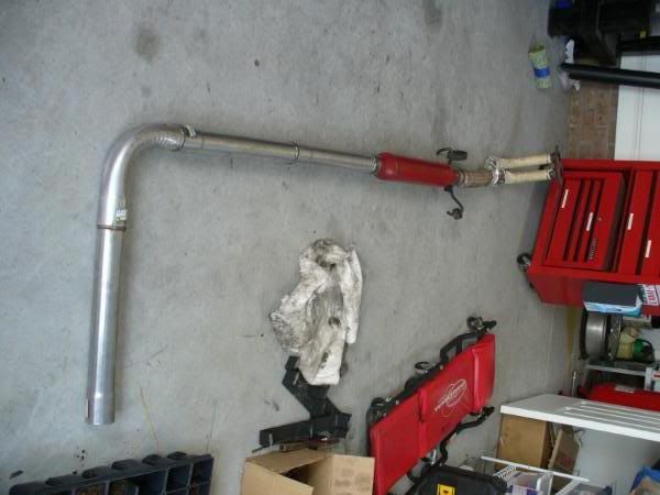

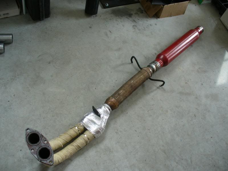

Pics of our Advance Auto style DIY side exit exhaust:

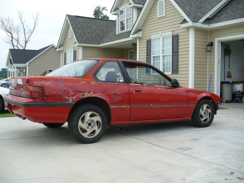

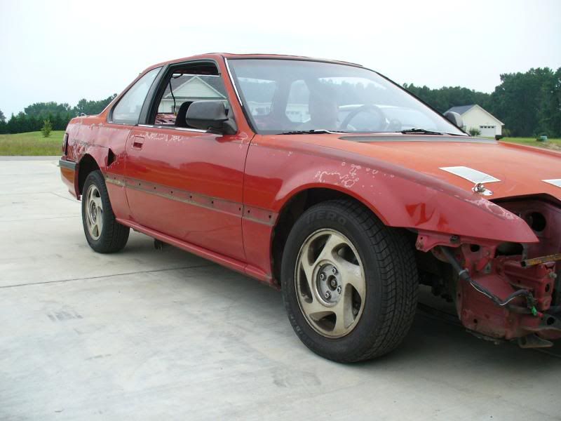

We (cough, Ryan, cough) miscalculated the rear spring rate/height and now RiZo has a drag car like stance. Yeah, we will need to remedy that.
actually, that was you welding something for the seat bracket, but i appreciate you bringing that up again :cry: :cry: :cry:

Compressing a shock how? If he was seating the top nut of the strut using an impact, well, that's pretty commonly done, although not the best method. - AB
PostPosted: Mon Jul 13, 2009 12:03 pm
You had to be there, but he just went a little too far with the gun. It was no big deal really, but we love to rag Chris at every opportunity. I just welded the remaining portion of the shock shaft to the top hat. It can't be removed now, but it will work just fine (rear shock) for LeMons.
PostPosted: Mon Jul 13, 2009 12:04 pm
You had to be there, but he just went a little too far. It was no big deal anyway, but we love to rag Chris at every opportunity. I just welded the remaining portion of the shock shaft to the top hat. It can't be removed, but it will work just fine (rear shock) for LeMons.
Very nice. Chris' prowess with tools is once again becoming legendary :) - AB

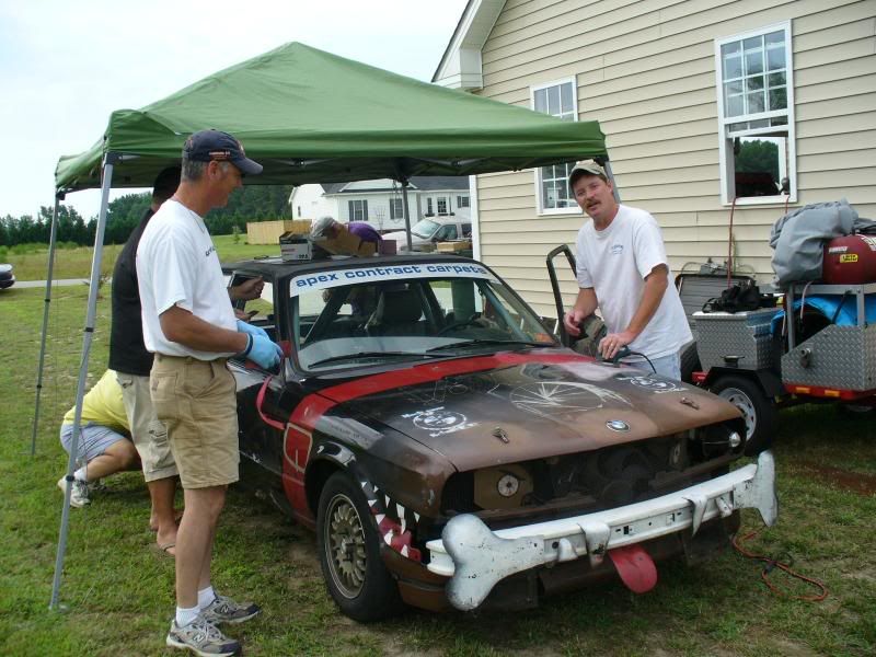

Since Team Dorifto Dogs was also in attendance at VK's household this weekend, we also got a helping hand from team Grim Reaper. Our car is undergoing a canine "species-ectomy" and will be a new breed for the September LeMons event.

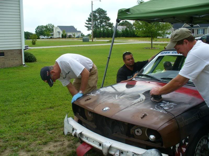

PostPosted: Mon Jul 13, 2009 3:10 pm
Is that Steve Remchak...working on a car! GASP! :lol:
PostPosted: Mon Jul 13, 2009 4:22 pm
Where BMWs come to die
Posts: 1398
He's not working on a car per se, he's working on the paint (which just happens to be on the hood, which just happens to be on a car).
Doesn't really count IMHO.
:wink:
BTW, what the HELL are you guys doing sanding on that car? If I send that pic to the LeMons judges you'd be banned for sure!! Sanding is not in the true spirit of LeMons.
