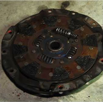

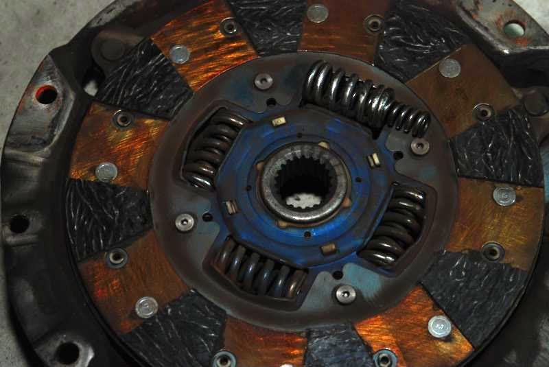

So, I think I may have found the issue with my car. As I said in my dead tranny thread, it was having issues shifting and made awful noises when it was in gear.
So, do you think this might have cause the problem...

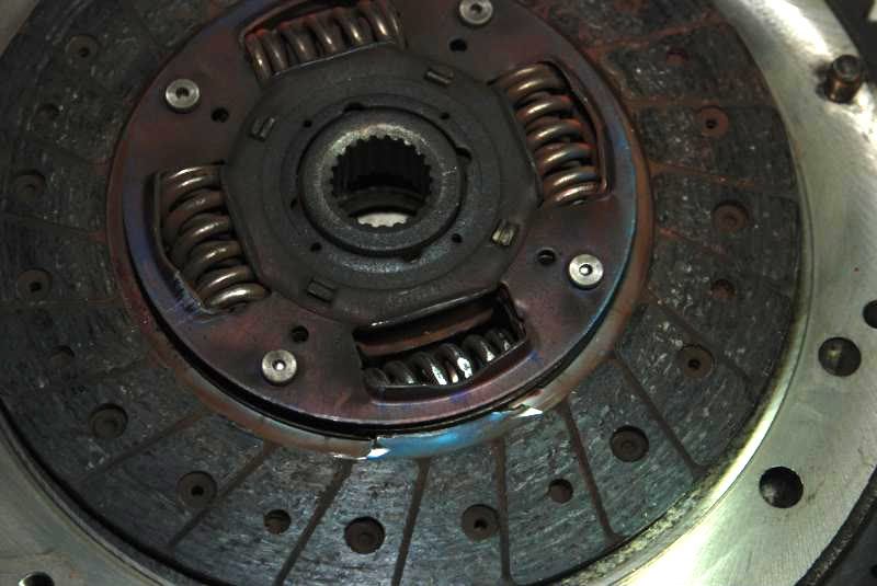

And this is the flywheel. The bearing fell right out when I took the clutch off. Also, you can see where the liberated clutch spring rubbed on the hub of the flywheel.
So, do you think that this may have been the cause of my problem or should I open the tranny and have a look inside? Keep in mind that transmissions scare me and I am a little aprehensive about opening it up.

Check the input shaft of the transmission for any abnormal play, and make sure that you can shift it into all of the gears with it disconnected from the engine. If those two check out, I would just put it back in with a new clutch, flywheel, pilot bearing and t/o bearing.

I had a spring pop out of the clutch many, many years ago in a 1989 Ranger ... very similar to your pictures. Nothing else was wrong with the clutch, yet I could not shift gears because of the spring.
I'd say you found your problem, but do as Jason suggested and see how well the tranny shifts while sitting on the ground.

Side question, do you think the flywheel is still usable, after obvious resurfacing, even with the scratch caused by the displaced spring?

If the resurfacing will take out the scratch, then I would say yes. The machinist that does the resurfacing should be able to tell you whether or not it is worth it and how close you will come to the tolerances.

Is this in the miata? If it were in a high hp / high heat application, I would be a little concerned with weakening the flywheel. They can do nasty things if they come apart.

I lightened my stock '93 flywheel when I had my CSP Miata. It lost about 4.5 # when T-Hoff did the work. After seeing one that has broken in a car, I will never do that again.
In your case Todd, I'd find a new one and button it back up. A broken spring will certainly cause the issue you were having and the Miata trannies are considered near bulletproof aside from some shifting grind at higher miles.
If you do resurface it, be careful how much material is removed so that you don't put yourself out of STS rules by lightening the flywheel. - AB

order a new one from Madaspeed thru the grassroots racer support program. Likely cheaper than even refinishing. I'd say that yours will not be able to be cleaned up tho.

if you do get yours surfaced it is not going to take out that scratch by the bolt holes. You also prob need to get a balance if you reuse the stock one just to be on the safe side! I would find a good used one and not worry about it while you got everything apart. I had the clutch in my del sol do somethign very similiar but i kept putting it off and when i went to change it the spriings had cut the bolt head to where you couldnt put a socket on them. I had no choice to but not surface and leave it in the car. As far as i know it is still going strong.
Good point... since that is not on the mating surface that is normally ground by the machinist.
