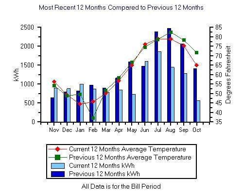

You can reduce your electric bill spring-fall by having window tint installed to reduce solar heat gain into your home. Unfortunately the data below shows my electric usage after window tint and hvac changes, but from a comfort standpoint the tinting makes the house noticeably cooler. I used nano-ceramic stuff, but there is less expensive film choices available, i.e regular dyed films like 3M.
February of 2008: window film installed and the savings begin.
(We use gas for heating.)
The spike in June was attributed to my upstairs zone hvac starting to die out. New system installed early July.
I keep my house very cool in the summer: Upstairs between 70-72, downstairs between 67-70 (with duct work/air flow to get the master bedroom down to 63 degrees at night).

What's the cost on the tint? We're probably in the market for new windows in the next few years (to go with the new roof). Apparently, if you don't keep up with the paint on wooden windows they will start to rot :( (duh)

Nano-ceramics: $11-16 sq/ft installed.
Dyed films: half that. Dyed films are subject to fade, though, so choose carefully.
I'd go cheap on the windows and add tint. Cost would be the same or less than going with 'better' windows. Be careful of warranty implications. Most good film companies warrant your windows since the mfg will cancel theirs out.

You still let solar energy in with closed blinds. What you stop is fading of curtains and furniture. Winter heat is temporary heat (it goes fast once darkness hits) unless you are intentionally heating dark tile or other thermal mass for slow heat release at night. I have seen no detrimental affect on my gas bill with the solar film.
