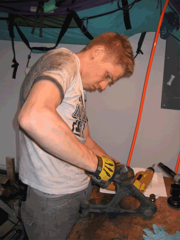

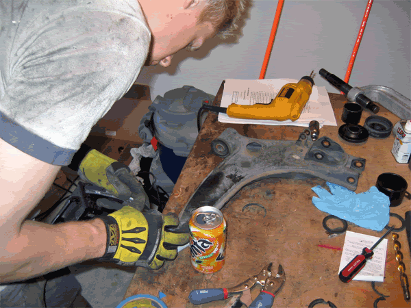

It's still on stands, but all of the Powerflex poly bushings are in and they went in easy, snug, but easy. The old ones were cracking and probably well past shot with 114K miles on them. They came out like a, well I won't use the word that I did in the garage, but it sucked.
BTW this is Sean doing the dirty work

Simple, yeah that was the word I was avoiding. J/K when we got into it, it wasn't that hard. Another example of the right tool making the difference. I still can't imagine what solution I would have come up with had you not offered your help. I still had one bushing that required a series of small drill bit holes to loosen it up, but most of them cranked right out with the HF 'c-clamp thingy' you loaned us.
