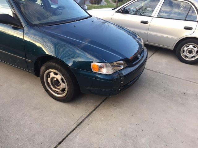

Following up on this thread, I decided to try to repair the car as cheaply as possible. Thanks to Bret L, I was able to score the airbags, seat belts, and fender liner from LKQ for 40% off on January 1st. :thumbsup: I purchased the headlight, turn signal, and wsw reservoir from RockAuto - best shipped price I could find. I repaired the wiring harnesses and pulled the under-hood bent metal as best I could by myself. Due to the price of paint and lack of correct color parts available locally, I decided to retain the front fender by bending it back as straight as I could, and I stitched the front bumper cover together with ty-raps. If I keep the car I'll continue to hunt for a junkyard bumper cover in the correct color - hopefully score one at some point. I still need to get the windshield replaced. Total spent so far is $140.
Here's what it looks like now (BTW, in the background is the replacement Corolla I bought a few weeks ago, required for my daughter to get to school) -

FWIW, I would think chances of finding a bumper in the right color are pretty good with that car, just keep checking the LKQ inventory and hope they keep putting little pics of the car so you can see the color without having to drive out there.
I bought an 03 BMW 530i several months ago with a huge dent in the RF fender, thought it would be no big deal to find one in the right color until I found out it was a 2003-only color. I pushed the dent out well enough to be able to drive the car and kept checking junkyard inventories, about 2 weeks ago scored a fender in the right color from LKQ. So for ~$50 the car looks great!
 Post subject: Re: (1/19/16 wrap-up posted) Car wrecked - what to do with i
PostPosted: Tue Jan 19, 2016 4:51 pm
Nice, looks good!
Just turned a $500-750 as-is car to an easily $2000-2500 one.
PostPosted: Tue Jan 19, 2016 5:13 pm
Well done Keith. That's the smart option, especially given that the car wasn't overly damaged. - AB
