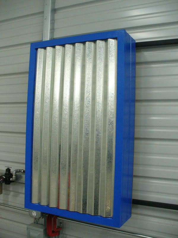

Dustin Fredrickson wrote:
Did you just glue the metal panels to the hardboard backing of your doors, or did you recess the (top and bottom at least) edges into the door frame, like a traditional door panel would be installed?
I used construction adhesive to glue the metal panels to the hard backing on the doors. The 1x2 frame of the doors created an 'edge' all around, which mimics the look of a panel door, but takes advantage of a more simple construction technique.
FWIW, I used a grinder to cut the corrugated metal, but a pair of pneumatic shears sure would have made it easier. Since I plan to continue this theme with other cabinetry, I think I'll buy a pair.
I'd be concerned with deforming the metal edges with shears, particularly since those edges aren't recessed, but I've never actually used the pneumatic variety so maybe this isn't an issue. If you try it let me know how it works.
The Pneumatic shears arent all that. I have a pair you can borrow

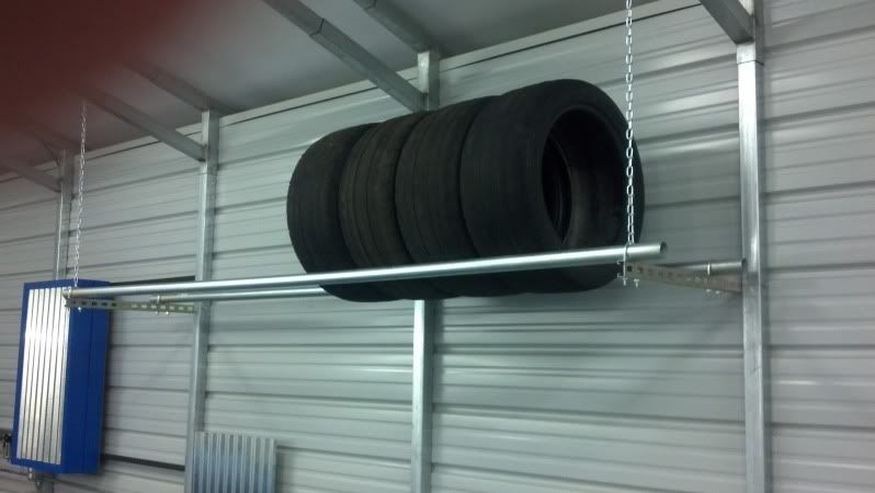

Update.
Since I own at least one set of extra wheels/tires for every car I own, I've needed a tire rack for quite some time. Right now I have them spread around in the garage, the attic, everywhere. I need floor space so it was time to get them off the floor. With the nice weather yesterday was the time to get to it. I didn't build the rack to hold _all_ of them (at least not yet), but it's a start.
The construction is pretty simple. I borrowed Mike's idea, but used different materials. As he said, the garage door angle stuff is STUPID expensive. At Lowes the price was $15 for a single 4' piece. I decided to use super strut instead which is beefier and cheaper at $15 for a 10' piece. The supports attaching it to the wall are sections of the super-strut that are suspended on the opposite ends with porch-swing chain and attached via bolts to the roof structure. In between, are two 10' long sections of 1-1/2" dia EMT conduit. The EMT is secured to the super strut with U-bolts.
Here are couple of pics I took, but it's not finished yet. There will be a center support, but I didn't have time to finish it today. Once I get that installed and tighten it all down it should be good to go...then I'll need to build another!

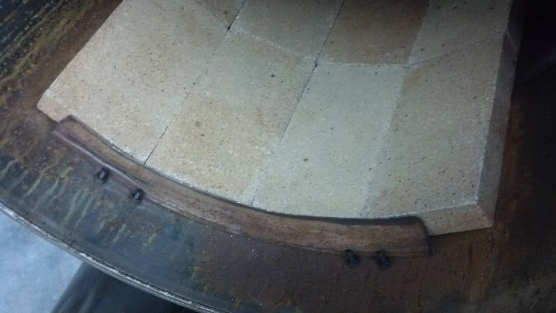

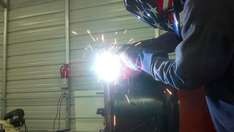

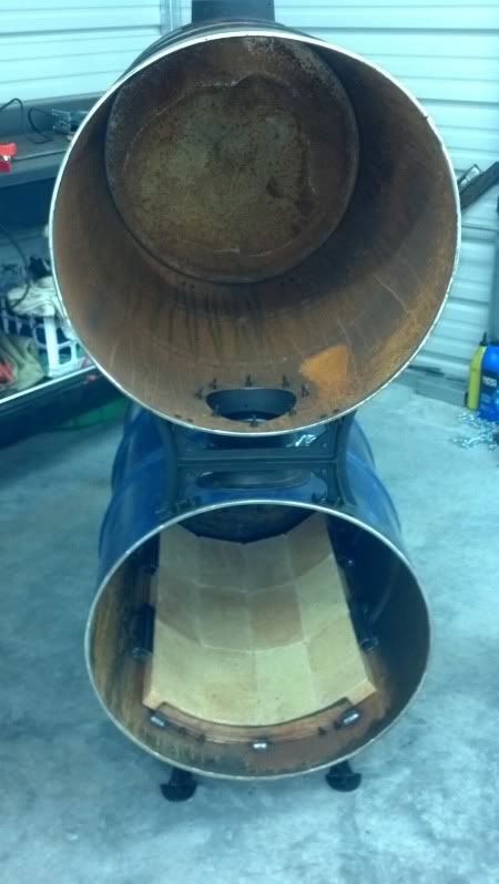

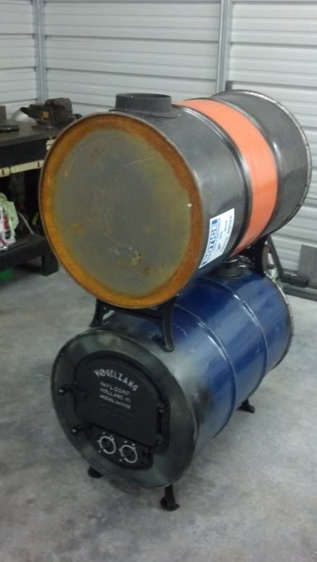

Update.
It's been a busy few days in the shop. Jason and I installed a set of long tube headers on his S197, and today Kendt, Ryan, and I removed the drivetrain in Kendt's Miata to make room for the future 5.0. However I did get one day to work on my own project, my barrel stove.
For those unfamilar with the concept, basically a 55 gallon drum is used to build a DIY wood heater. NT and others sell a kit made from cast iron to add a door, legs, damper, etc. They sell another kit to adapt a second drum on top of the first which acts as a heat exchanger increasing the thermal effieciency by a factor of two.
Ryan sourced me a couple of barrels several weeks back, and I ordered the kit to start putting it all together. The barrels were open-ended so I had to weld the ends on, which was actually easier than working with an enclosed drum.
To make it last longer, I added 12 fire bricks to the inside of the bottom barrel where the actual fire will be. I added some steel tabs to keep the brick in place also.
The pics below show where it stands right now. Basically the next step is to build a fire and burn-off all the existing paint on the drums. After that is complete I can re-paint the drums with high-temp grill paint and plumb the chimney in place. Once that is done it will be ready to use.
