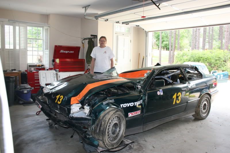

Sorry for the silence and thanks for asking. I'm doing great. Still working on the recovery, but I am getting back to semi-normal. I use a cane most of the time, but I am walking around fairly well. Now it's just a matter of keeping at the therapy and continuing the progress.
Here's what the car looked like.

Colin,
I am really glad to see your progress.
And the car is something to look at. It really shows how well the safety stuff really works.

PostPosted: Tue Jun 12, 2012 9:51 am
eh, that should buff right out.................... :eek:
glad to see you are up and around again.

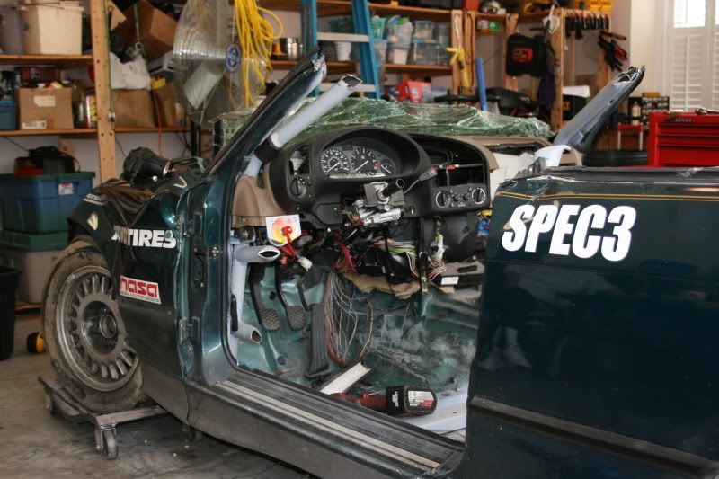

Glad you're doing well.
Could you please post close-up pictures of the cage, especially cage design around the fail points? You might just save someone else injuries in the future if you do. Thanks

PostPosted: Tue Jun 12, 2012 10:25 am
Glad you are doing well. Its quite amazing that you can even stand after seeing the remnants of your car.
Just for reference they had to cut him out. The top of the cage and roof were removed.

Yeah, I could have made that clear. They had to cut the top off the car to get me out.
I hit the wall straight on in turn 1 at Summit Point. It was a hard hit, but not 'that hard' and I should have walked away from it. During the impact my upper body was held in place, but the lap belt (although tight) allowed my lower body to move forward. I remember the feeling of the sub-straps catching me. The pivoting motion completely disintegrated my T12 vertebrae, paralyzing me from the waist down. The only way to get me out of the car was to lift me up and out. Thankfully, the EV workers did everything perfectly and I'm walking today because of that.

Good medical care and transport FTW. If you're not comfortable with a full-on post-incident review, or posting details that's cool and perfectly understandable...but I was wondering what the cause of your "off" was--brake failure? Loss of grip? Pushed offline? Earlier it was mentioned as either brakes or hydroplane, but I was curious if any details had surfaced since then. Thanks.
