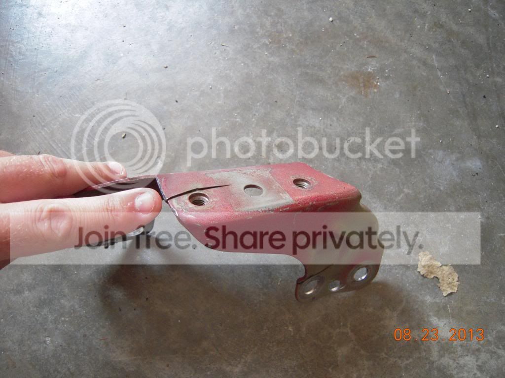

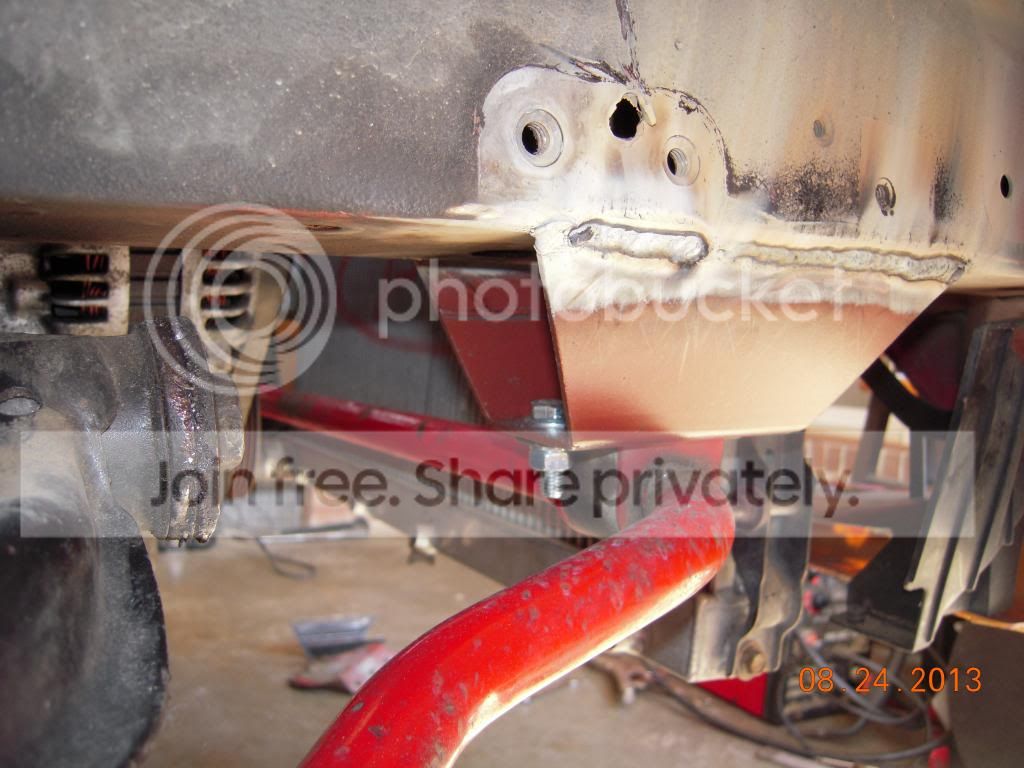

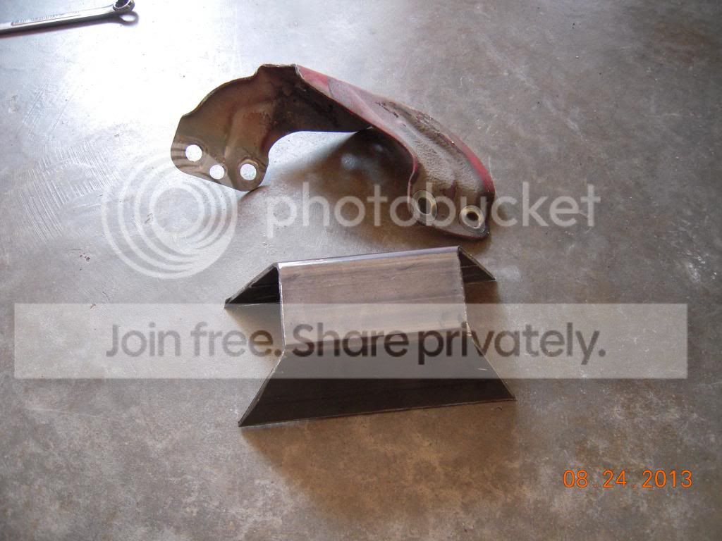

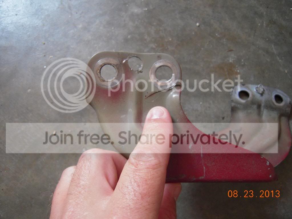

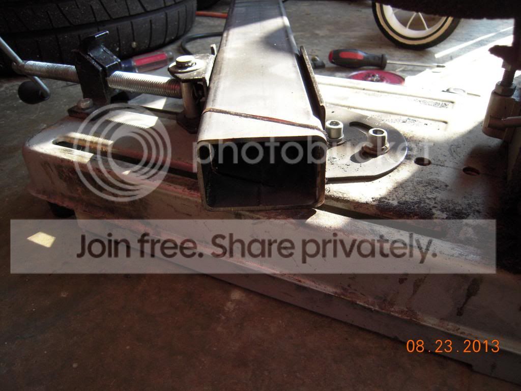

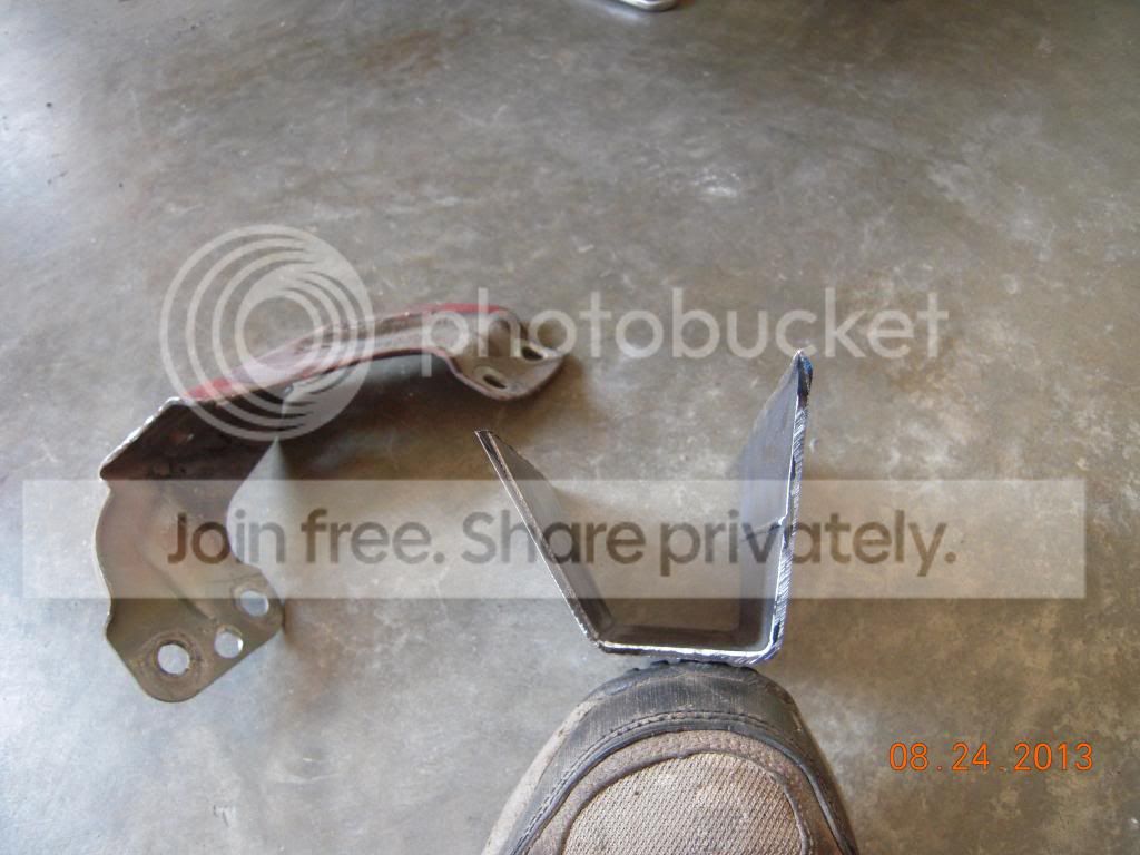

So Andrew, many thanks for that video. It was not until I was removing my stock sway bar brackets that I found the damage. All things considered, I got well over 100 autocrosses for the damage to get to the point shown in the pictures.
For the new mounts I wanted to do something different. the idea was to weld them to the car and have them retain the same functionality as the stock pieces, be stronger, but no heavier than necessary. I considered drilling a large hole in each side to make them lighter, but whatever. Also important is that I can remove the upper control arm inboard "long bolt" in the future without cutting or grinding. Stock mounts with bolts weigh 13 ounces, these come out to 17.5, so not bad...assuming they are strong enough :D
