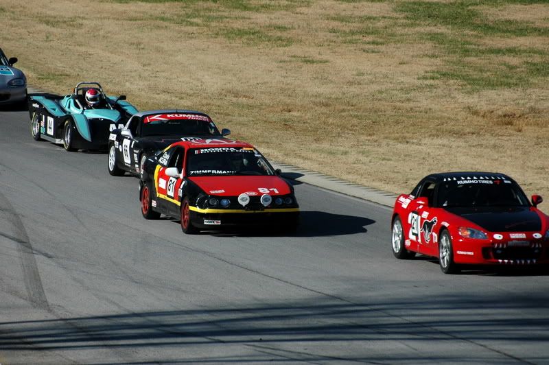

I was wondering what eventually happened with the RSX. Thanks for the report Donnie. We had to replace a rear upper control arm, front axle, brake pads, and buy a new illuma-board for the #81 Integra. It was a great but very long day where I got to hang out with a great bunch of guys and have fun even though we kept praying the car would hold together. 2nd place in ITA and 29th Overall isn't too bad. We were as high as 9th Overall at one point before the problems started setting in. James put down a best time of 2:19 early in the race.
Here is a picture of the car from early in the race before the rear bumper decided to eject from the car.

Is that Blue/black sports racer a Toyota Challenge car?
PostPosted: Mon Nov 10, 2008 12:05 pm
Looks like a Spec Racer Ford to me. :shrug:
PostPosted: Mon Nov 10, 2008 12:09 pm
I think your right.
i saw that car late in the race and it looked pretty banged up...unfortunately it was dropping some fluids that i didnt see until i was right up behind it (it was as kinda dark, lol) and i went for a little ride in T5...luckily i got out of everyones way... :shock:
The up side to working this comer was the food! Mark Senior started us off w/ some ribs and polish sausage and it was outstanding. I followed up w/ some wings and Chuck Stanley pulled out all the stops w/ some Cajun style linguini! We actually won the cook off among the stations that were cooking. Had a great time working the corner and watch the cars. Never a dull moment...
lol...one of our drivers kept commenting on how good the food smelled over at oak tree...he said he wanted to stop and grab a bite but we talked him out of it :wink:
definitely a spec racer ford...you can see "SRF" behind the number board...

David White wrote:
Well looking at the actual picture would have made things easy. I prefer guessing. :?: :lol:
