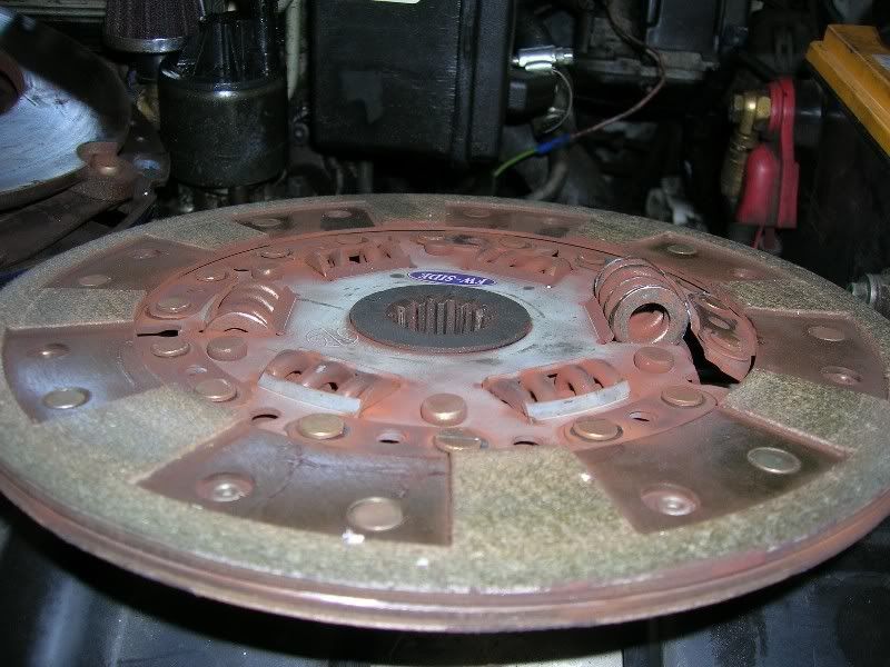

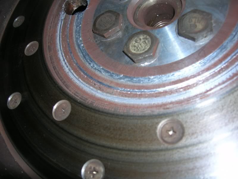

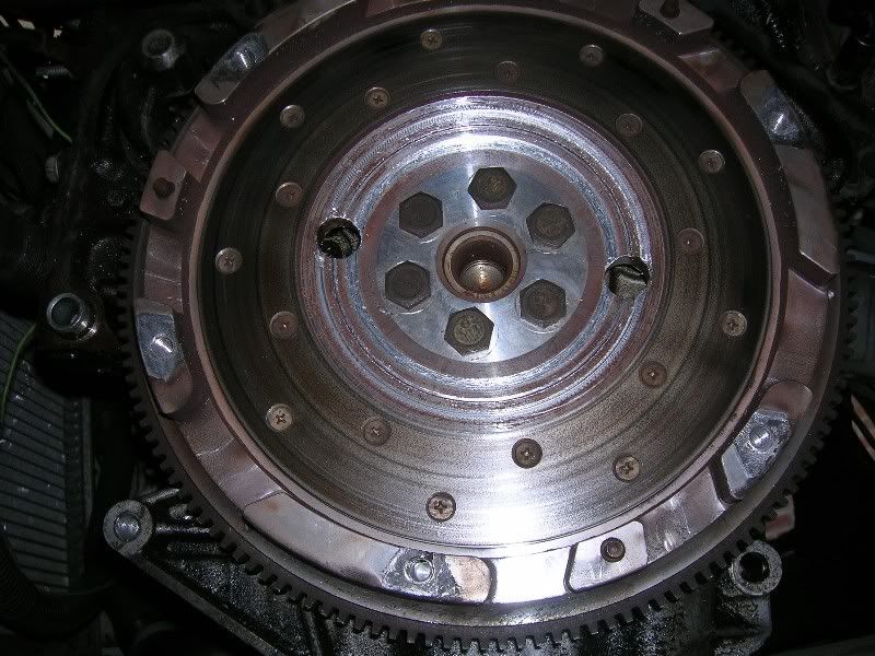

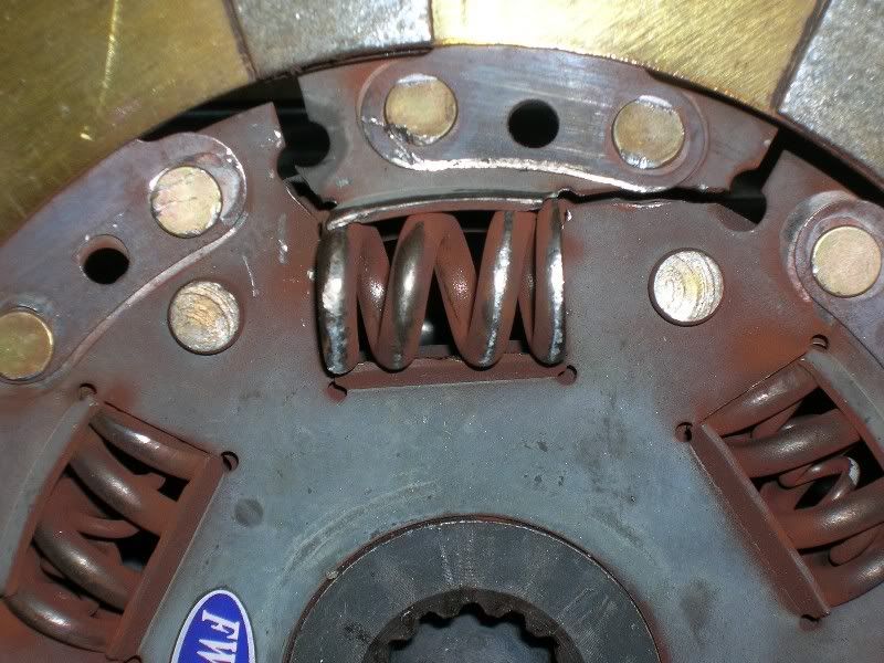

Everything was fine on my end Friday (brakes, tires, etc) until my first session on Saturday. About three fourths of the way thru the tranny didn’t want to go into 4th without putting serious effort on the shifter itself. After the session I put the car on ramps just to check the fluid level and see if there was anything amiss. Upon crawling under notice a perfectly spiraled piece of aluminum sticking out between the tranny and engine. There is a small plastic shield that covers the flywheel and it was protruding from there. I’m not expert, but pieces of metal usually ain’t too good.
Update. After pulling the tranny I discovered the problem, and after a new clutch disc it's all better now. Here are pics showing the carnage. You can see one of the springs became unseated in the clutch disc when the metal around it broke. It then proceeded top carve a nice groove aroud the inner edge of the aluminum flywheel thus the metal shavings I saw at CMP.
