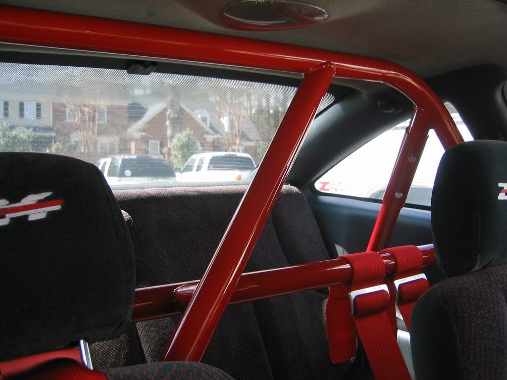

Hats off to Chris Schimmel on an awesome job. He got the job done 9 days ahead of schedule, allowing me some time to get the car ready for Roebling.
Here are some photos of the cage prior to the dash going back in.
Chris did the mandated right side net, battery hold down, tow straps and window net in addition to the cage.
I will paint the interior and cage white prior to the VIR date.

The welding is great. But the entire design and thought process behind it all is what amazes me. He is a great combination of technician and artist.
There are 3 or 4 little nuisances in the cage that will serve to really stiffen the car up but also be within the rules of not serving to stiffen the car.
Now just have to make sure it comes in under 3000# race ready minus fuel and driver.

Awesome. Chris does great work!
For those that have never seen it here is my roll bar fabbed and installed by Chris.
