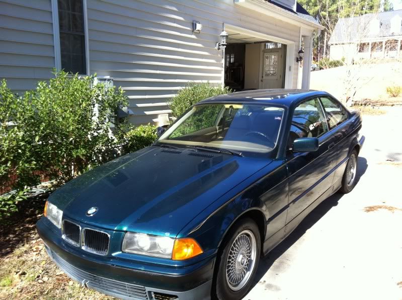

Picked up an ugly 325is last night with visions of building a NASA Spec 3 toy over the winter. Well actually two Spec 3's.... we'll be converting Sean's into Spec 3 along with this one.
The body, engine and tranny appear to be good. Anybody need tan interior parts?

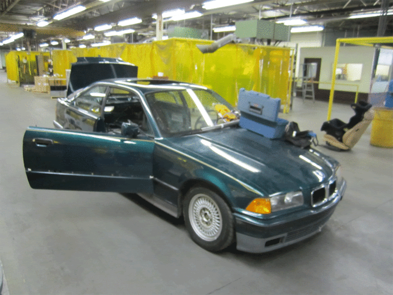

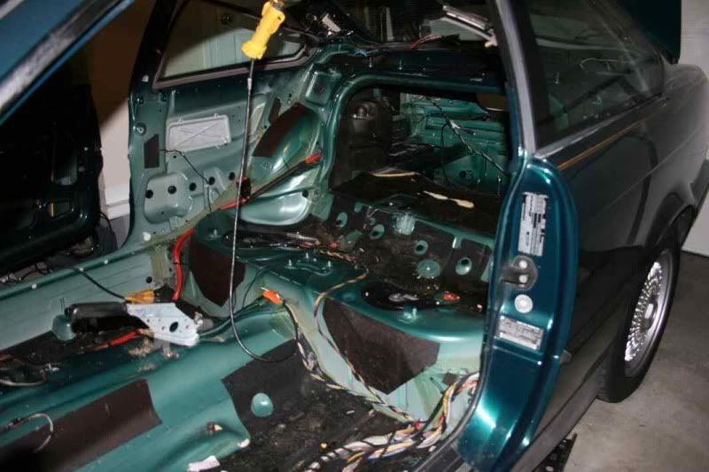

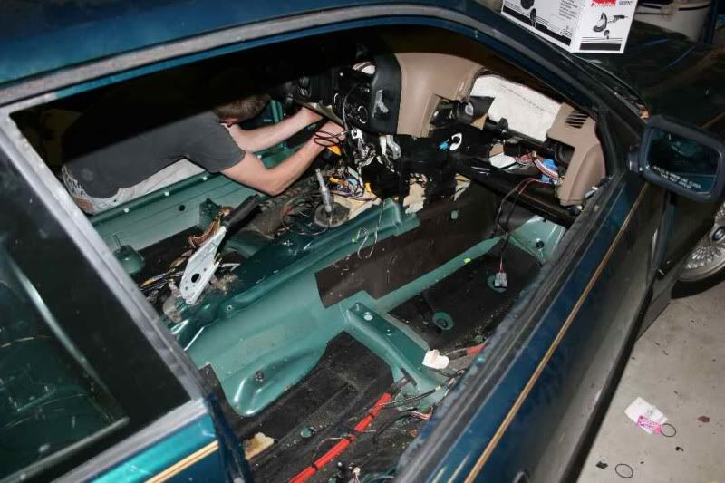

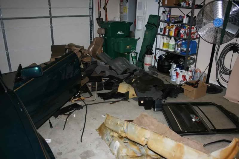

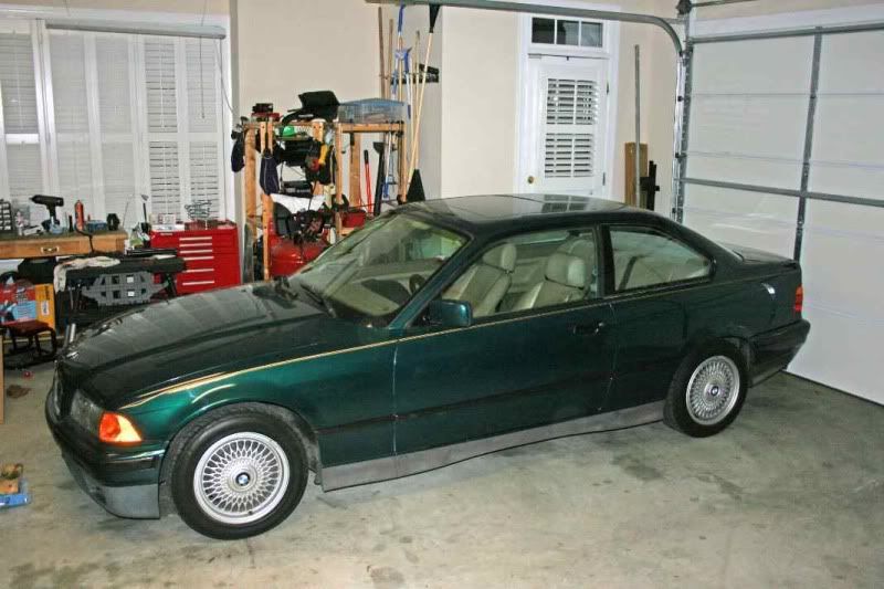

Day one - tear down begins with a roll into the operating room:
It's all gotta go:
Quite a mess:

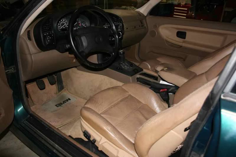

JohnByers wrote:
What kind of shape are the front seats in? With some work I have heard they can fit into an E30 and I really need to replace mine
A bit rough, but no tears (some cracks). They could be fixed up to like new by one of the local Fibrenew guys.
PostPosted: Sun Nov 21, 2010 6:10 pm
A closer look at the seats in daylight shows some tears and ugliness. Probably not worth salvaging.

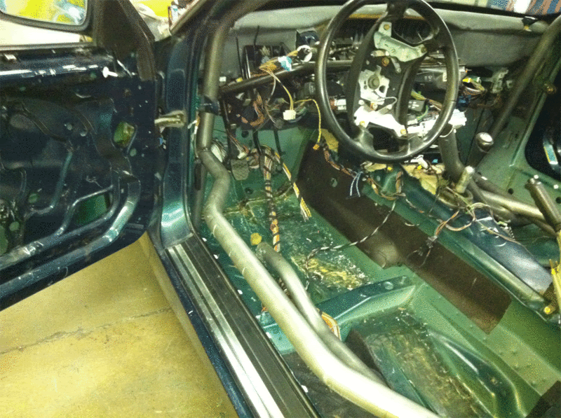

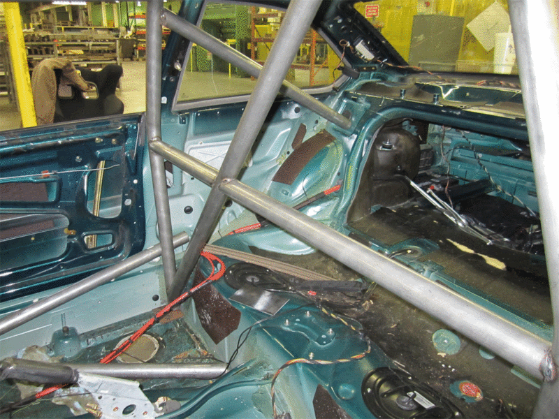

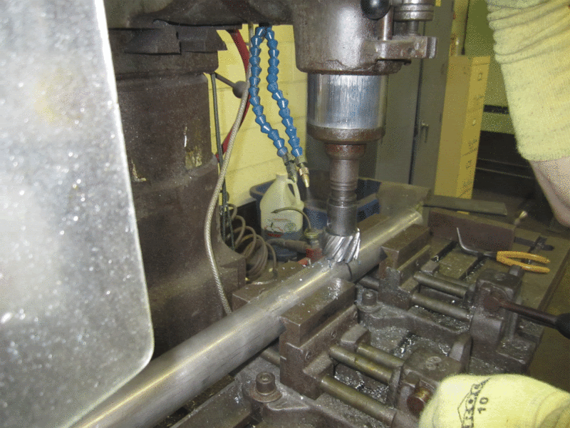

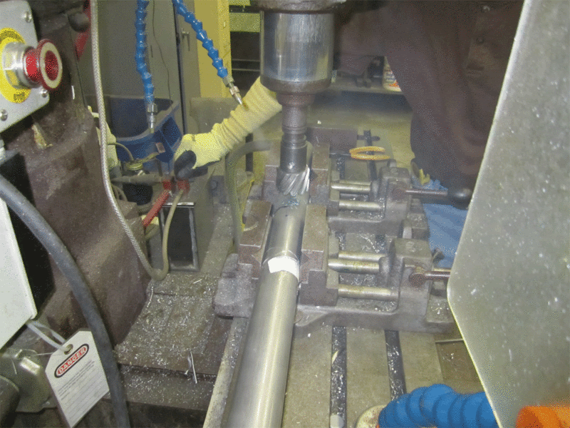

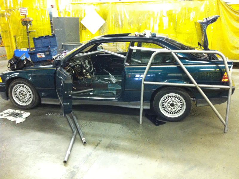

Okay, I spent the day working on the cage setup. Here are the steps - Cut conservatively, fit, wiggle, mark, cut again, fit, wiggle, mark, grind, fit, mark, grind, fit, mark, grind...grind...grind, fit....cuss...cuss again (better profanity), mark, grind, fit, mark, grind, fit... okay. Start on the next joint. Cut conservatively, fit, wiggle, mark, cut again, fit, wiggle, mark, grind, fit, mark, grind, fit, mark, grind...grind...grind, fit, mark, grind, fit, mark, grind, fit... okay.
It's nice to have access to good equipment.

Better be careful about showing that access to good equipment. Some of might ask for access to it too :mrgreen: Looks like solid progress.

Any utility to extending the cage to contact/attach to the rear strut mounts, then incorporate a rear strut bar? I hear the strut towers are an E36 weakspot, was curious if including them in the cage would strengthen that area--or would it violate Spec3 rules for cage specifications?
Thanks for sharing your build progress!

It's allowed and I've seen a few cages on line that are done that way, but I bought a kit from Kirk Racing and the rear bars are not done that way. The rear strut tower has the reinforcer plates.

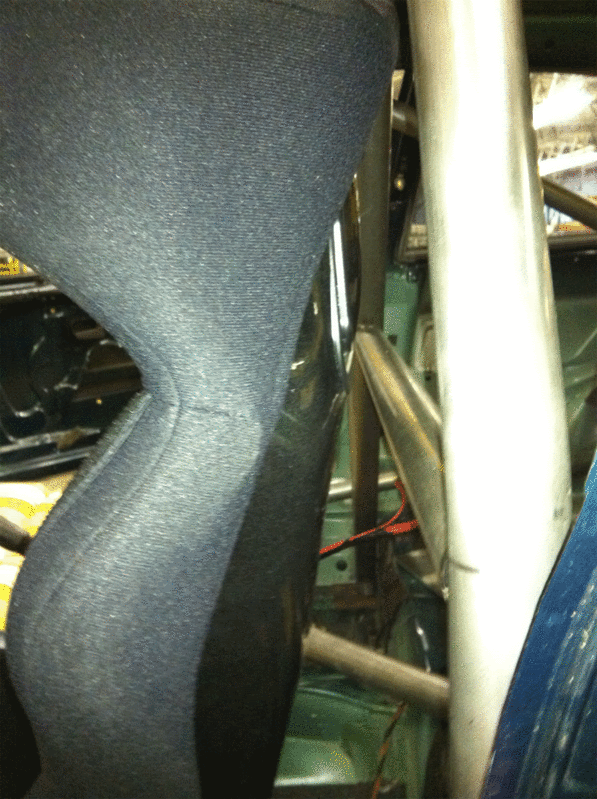

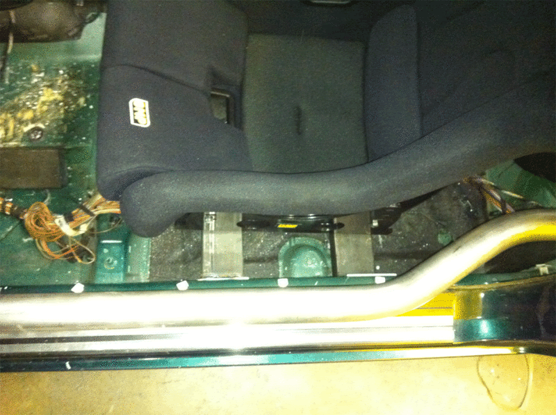

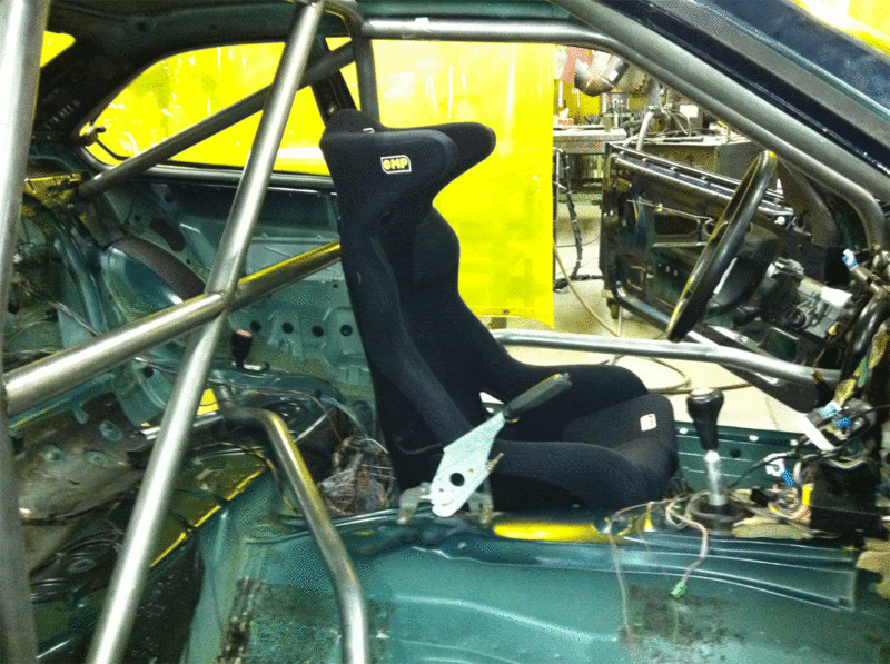

Made the seat mounts today and worked on cleaning up the mess of wiring that runs to the trunk. It all ran through a hole located right where the rear bar gets welded to the bulkhead. I had to unplug identify and pull them all through the hole so I could re-route them.
Cut and shaped new floor mount bars
Close to the right position.
I'm going to need a harness bar, the Kirk horizontal bar is too low.

my cage has a bar that crosses from the hoop behind my seat to the base of the passenger side floor mount Colin. granted mine is mounted inboard to the floorpan rather than the wheel wells but it would seem to me to be an extra level of protection to add another bar.
i also have a seperate bar across the rear shock towers, which makes me wonder this. does Spec E36 allow the X-brace / cowl brace from the convertible / M3?
