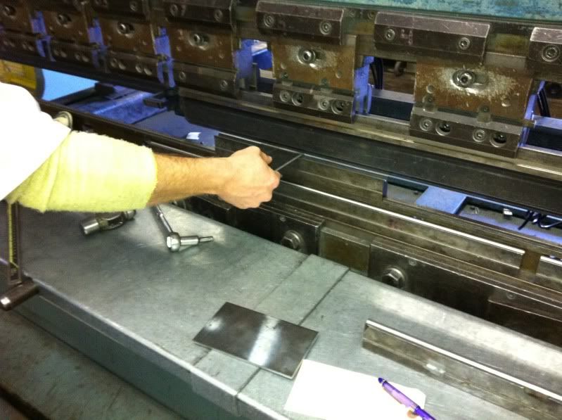

This so beats a vice and a sledge hammer to put a bend into a piece of steel.

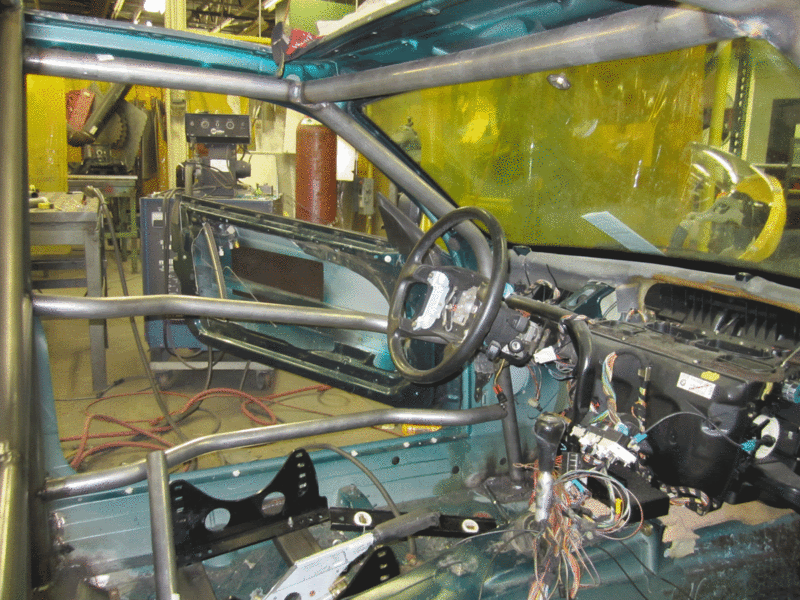

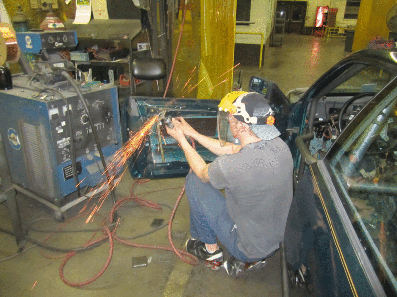

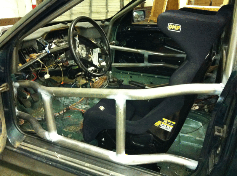

Cage build is progressing nicely. We got everything welded in today except the door bars. Drivers are tacked and passenger side is waiting for some attention. I wasn't nearly as close this morning as I thought I'd gotten in fitting and notching. We spent too much time today cleaning up my previous work prior to welding. The actual welding part didn't take 1/3 of the time spent today.

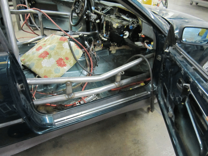

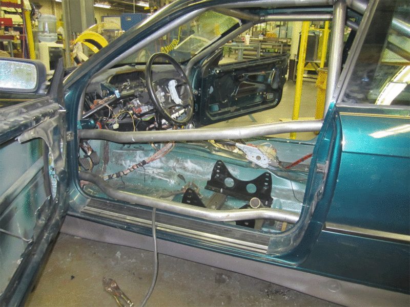

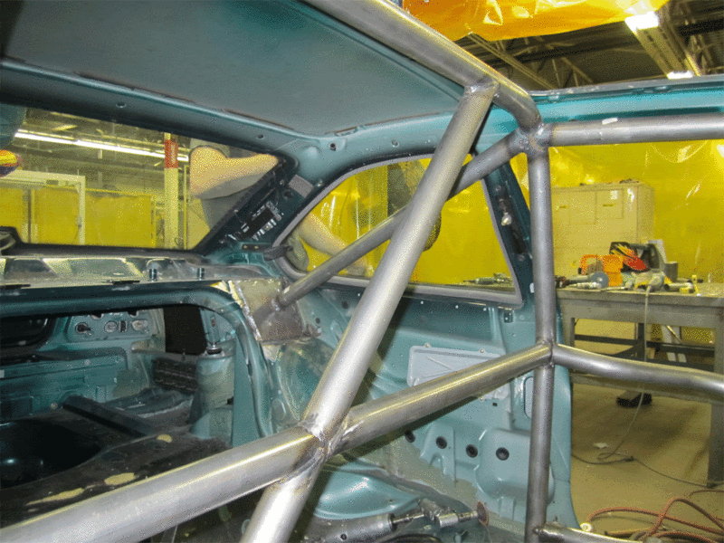

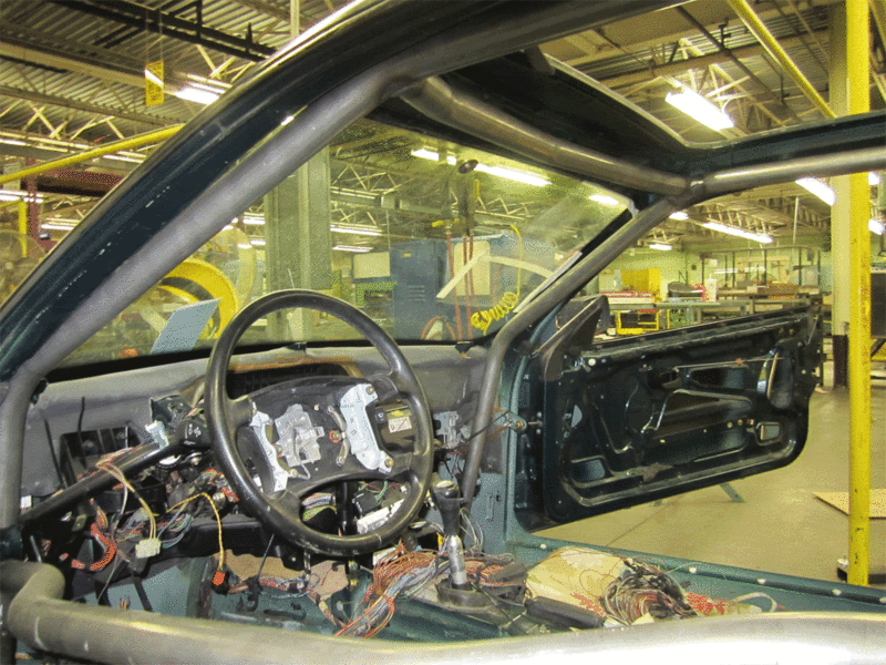

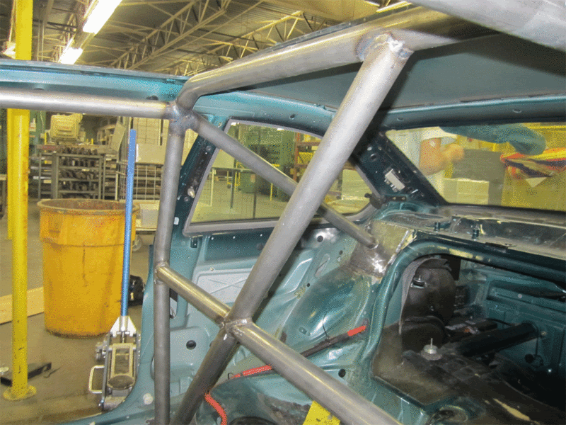

The cage is complete! One long weekend of prep work and one looonggg weekend of fitting and welding, but it's done! There's still things to buy and time to put in, but the cage was the big stage of the project and it's done.

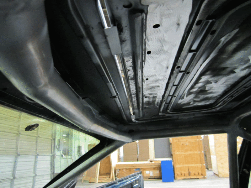

Note the sweet sunroof clips I found in the shop. These little U-channels were simply perfect. I welded them to the roof and set the sunroof in and bam! they were perfect. The sunroof sat perfectly and needed no fidgeting and tweaking to fit.

find some metal rod to place in the channels above the weld mounts. better than body putty, will not crack out later on.
nice door bars BTW. :thumbsup:
 Post subject: Re: Track build starting (spec 3)
PostPosted: Mon Mar 07, 2011 12:37 am
find some metal rod to place in the channels above the weld mounts.:
You lost me... do you suggest metal rod as a filler and welding instead of fiber bondo? Maybe metal rod and then some bondo? Welding on the thin body metal was such a PIA that I'd be inclined to use old bubble gum before welding that heavily on the roof.
PostPosted: Mon Mar 07, 2011 8:16 am
yes metal rod in the channels. you don't need to weld the whole length of the rod just sort of tack it in a few places. then fill the voids with bondo.

I like the sweet little flowered seat cushion, did you borrow that from my Nana?
PostPosted: Tue Mar 08, 2011 10:54 am
I saw one in Somebody els's build pictures and liked the idea of having padding while crawling around inside. The cheapest one on the shelf at Lowes was also the prettiest :)
