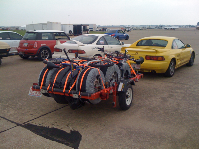

How many tires did we take to Lincoln? This many:
:D
There were 14 on the trailer and 4 more in the Type R. We also had an additional 4 waiting on us at the hotel. Our situation was a little funky in that we had tires for 2 different cars and we both ran the Pro Finale and the regular Championships. I also rented out the MR2 for the Championships so we technically had 4 drivers over 2 events. Oh yea, we also took a bunch of runs on the practice course. Our saving grace was that we won all those tires during the course of the year so our only out of pocket expenses were the trip costs and tire mounting.
We also have plenty of tires left over to use well into next season. They can be used as handy makeshift furniture too. :lol:
