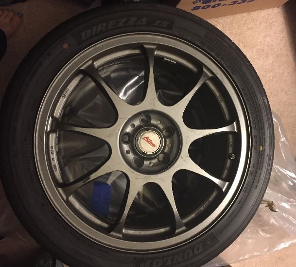

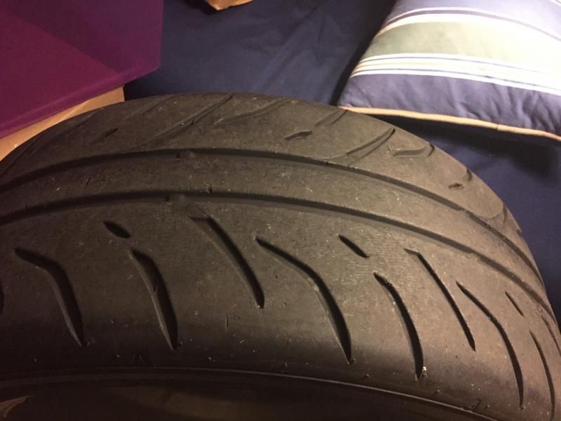

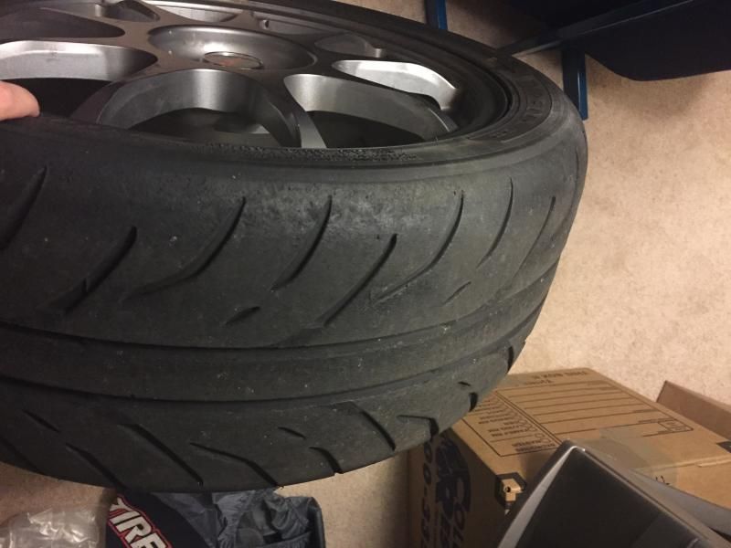

Good to hear about your 225's too and had no idea the sidewalls were so different than the Hankooks. Strano and a few others were telling me that 235/40 on a ZII is a good combo since they don't mind being squeezed onto the rim, so we'll see. Here are a few shots and they look good for ~30 run tires I guess.
 Post subject: Re: C Street related: 235/40/17's on a 7" wide rim?
PostPosted: Fri Jan 16, 2015 1:14 pm
are those fronts? If so, that's impressive how the wear triangles show no change.
If Strano says they will work, I'd go with it. He's pretty good. :wink:
